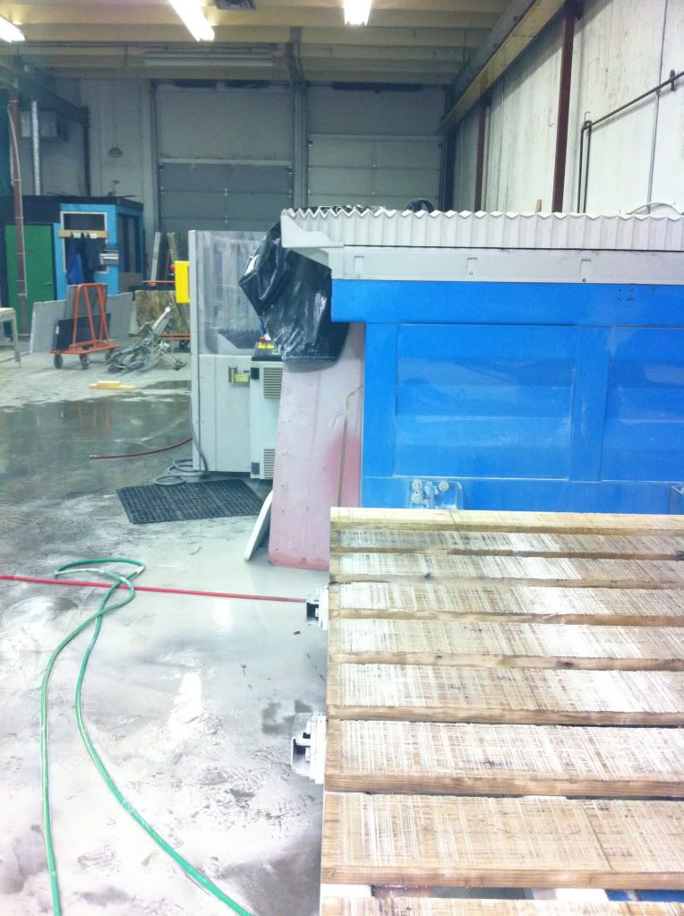

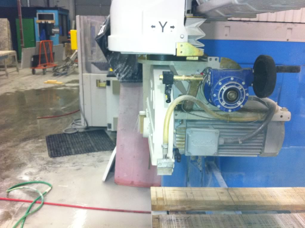

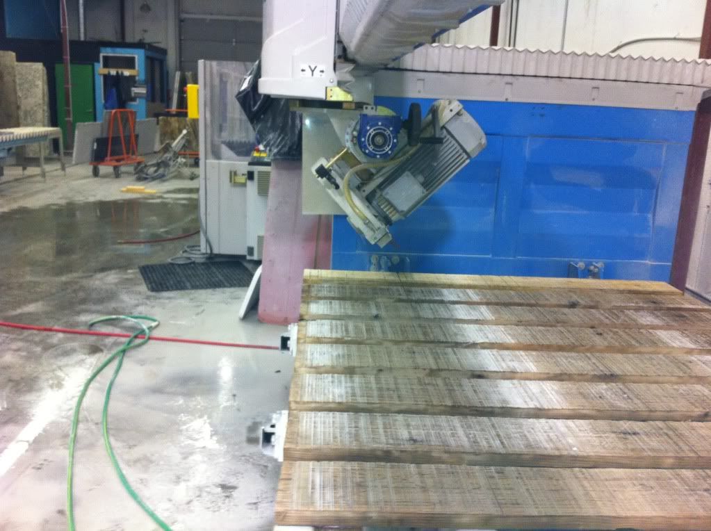

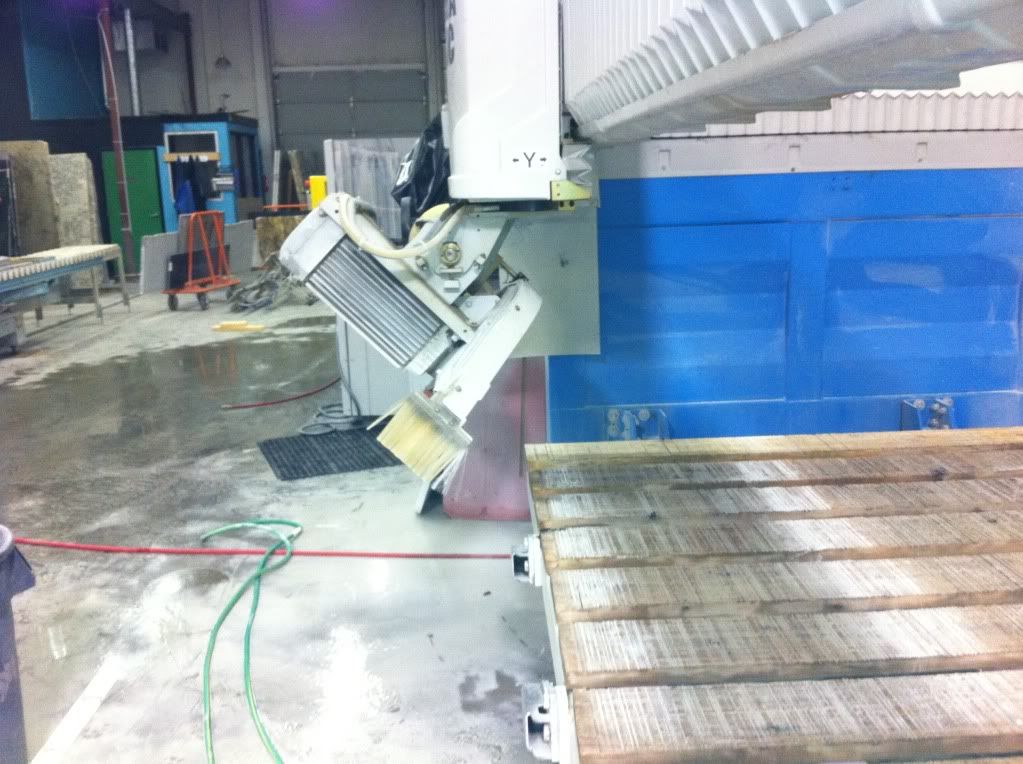

Dan the blade is offset from the center axis of the rotating head. So when you rotate at a 45 the head is even more off axis.
Cutting a book match on my saw I have to be 10 or so inches from the end of the Y axis in order to bookmatch the mitre.
I will take some photos tonight and post them up to show the way it is all wacked out.

Re: New CNC Saw by GMM
Saw head at zero and all the way to the front of the Y axis travel, right on the stops
Saw head in the same position, but tilted to 45 degrees, again all the way on the Y axis stops
Same position again but head rotated to 180 degrees to show a bookmatch cut.
Showing the Y axis stops in comparison to the table. You can see the table is almost even with the end stops. In an ideal situation as you can see by the photos the Y axis would extend another foot past where is does now. That way you could bookmatch your mitres and get a much larger yield when doing so.
This is what I hope this saw doesn't do and I am sure doesn't. But I just wanted to bring the whole mono block design flaws to the attention to those who might be buying one.
