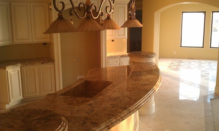

You lost me with the picture, that is a stepped edge?

I added the picture just because I wanted a picture up, we do very nice work. In the north west our little shop is looked down upon. Maybe because our prices per square foot is cheaper than the big shops.
Back to the point, we have done a few stone miters, and the tape works, just wondering if the miter clamps were faster, and done a better job at the corner?
