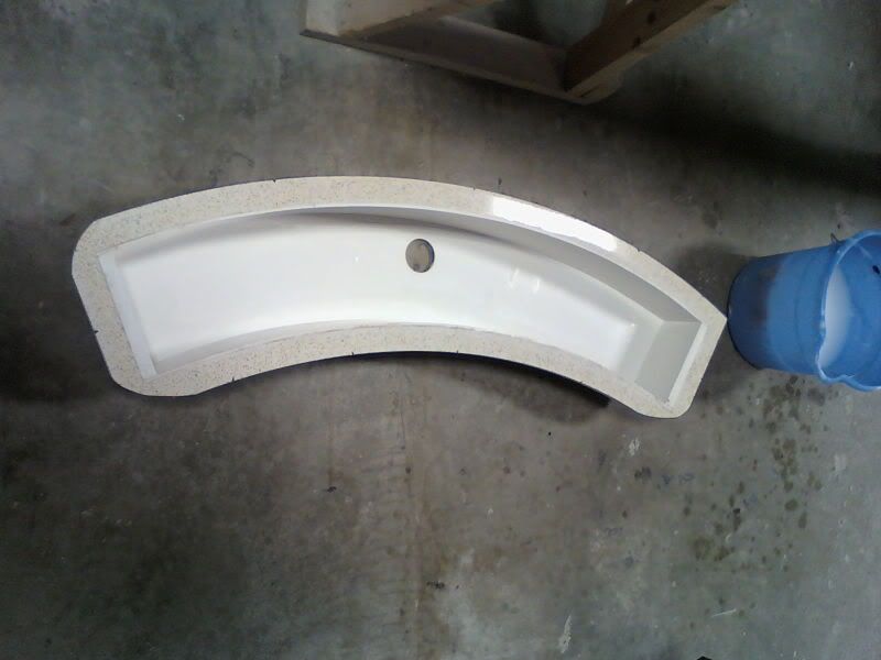

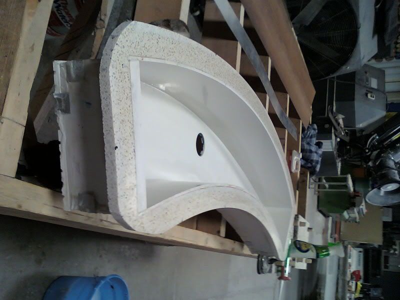

The bottom piece you can relief mill the bottom in an X shape, then set it on some 2cm blocks in all 4 corners and thermal form it to get a slant. Heck I would thermal form the face and laminate to a solid piece to give a curved effect with a nice fancy cap piece in front to hide the seam. Quartz can be fun to play around with. Here is a pic of a curved sink I made for a showroom display. Front and back are curved and so is the bottom.
Photobucket wont save it turned properly, my apologies.

Make a mold or form to bend too. For the sink above I made a solid block mold to glue against after shaping. That is Ceaserstone but im sure any finer grained quartz would work. Big ole fish fry pot to get lots of boiling water. Mill the pieces down to 3/16 or an 1/8th. I have done complete circles for bathroom windows(sorry no pics) and you will brake some pieces. Practice clamping and I have used ratchet straps. I should make a tutorial some day when I get some time.
