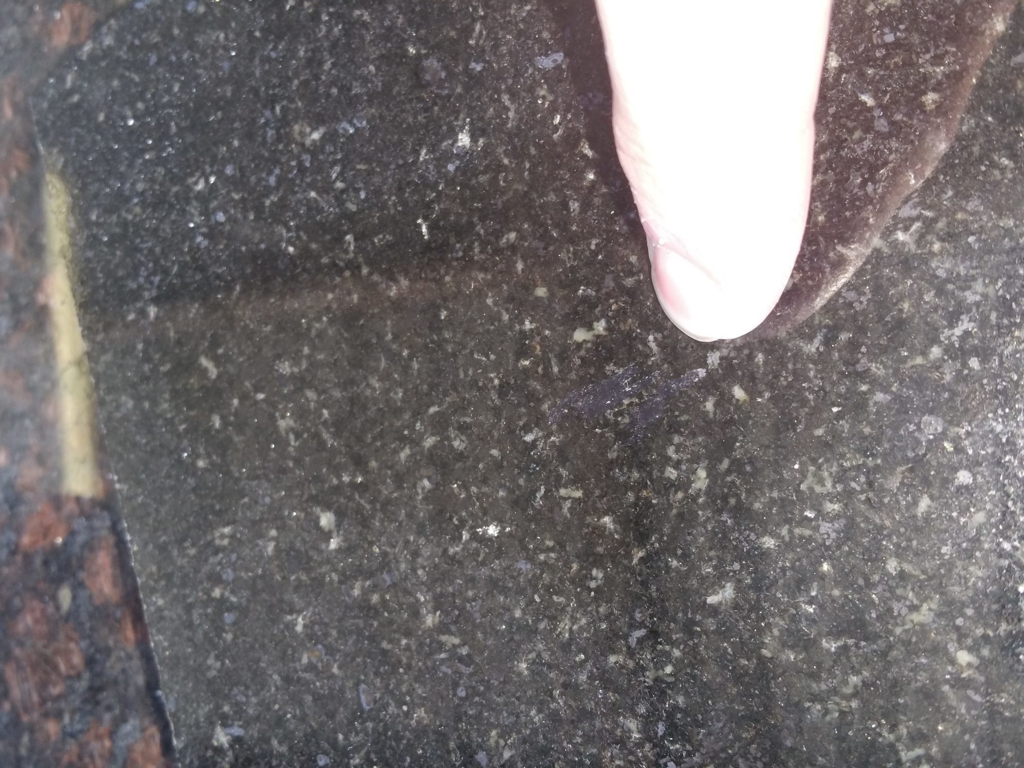

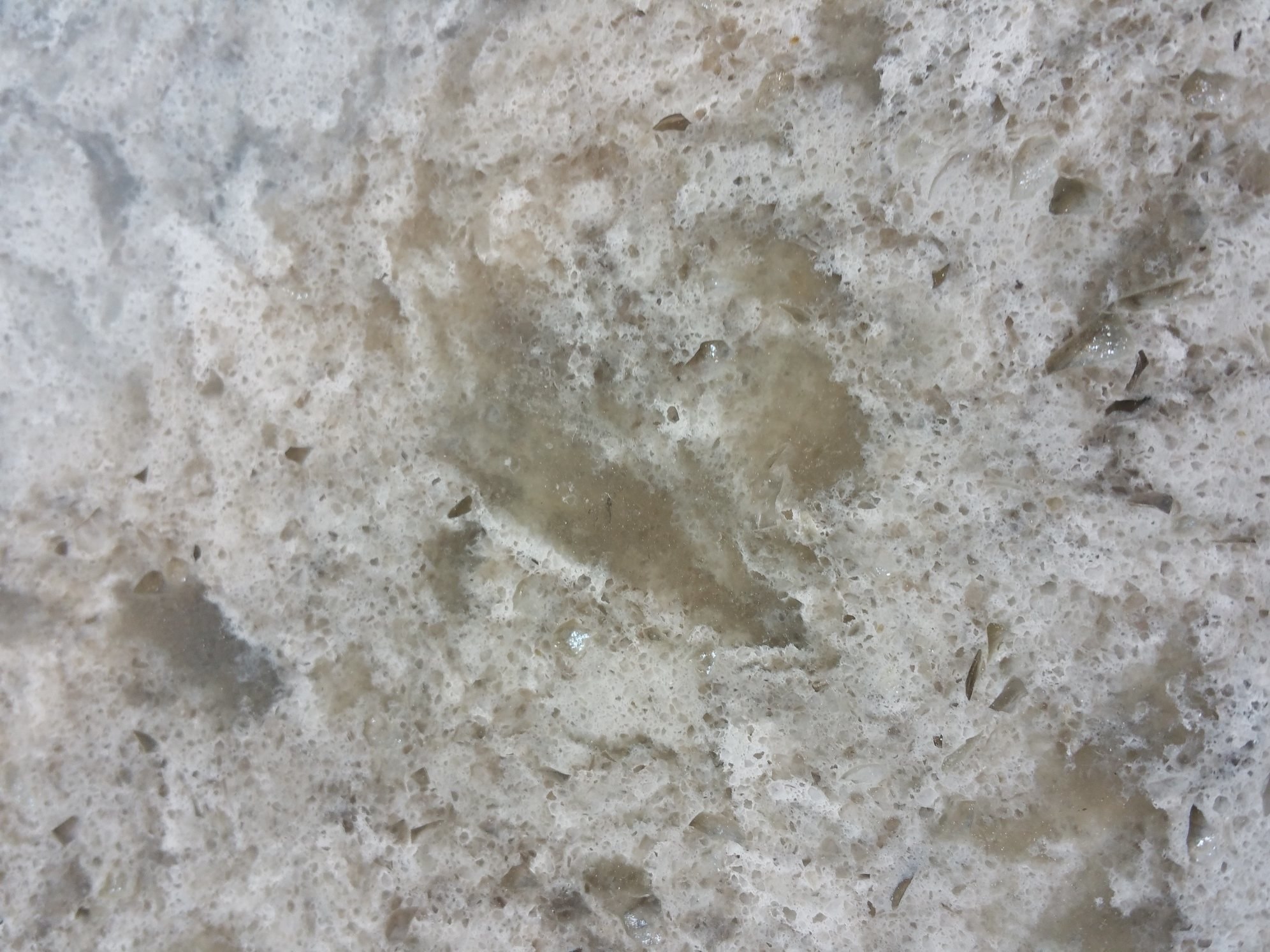

Here are a couple pictures of the fil-a-chip demo
I think this is one of those products that once you see and use it, you won't know how you lived without it!
What impressed me the most is that the Polish of the glue actually matches the shine of the face!

It is truly amazing at what this stuff can do! I put a pretty big core bit mark in some Cambria. With just a touch of the polishing compound the polished matched perfectly!

On the first black granite repair did you add some sharpie before the adhesive? It almost looks blue instead of natural black. You don't need to add color usually to the chip with the UV cure repair kits.
- Caleb
- Posts:1750
- Been thanked: 71 times
Re: SFA Workshop in sunny Arizona!
Eric is coming out with some tinted fill soon. Right now with the clear on AB it's tough to hide. We used some tepox then sealer before adding the clear, which help - but the best solution will be the new tinted colors. On other stones like the tan brown and Cambria the clear disappeared completely (possible with ca also) but unlike ca you can get the fil-a-chip to shine nicely!
