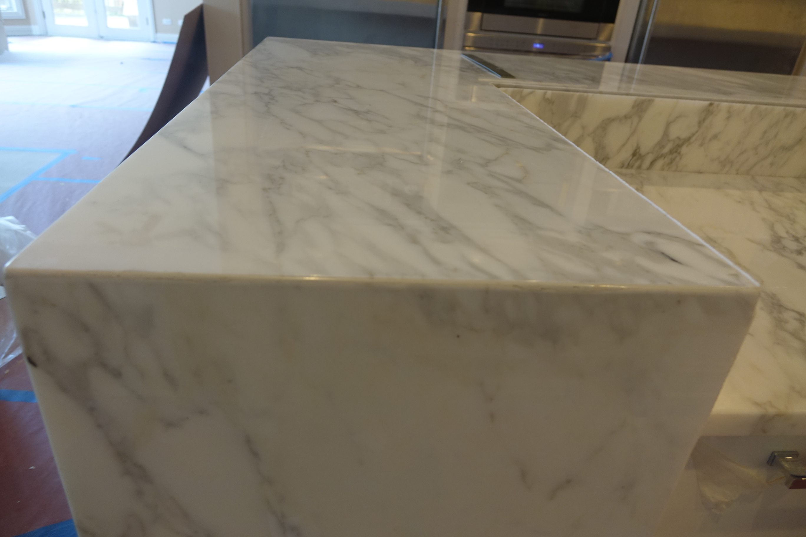

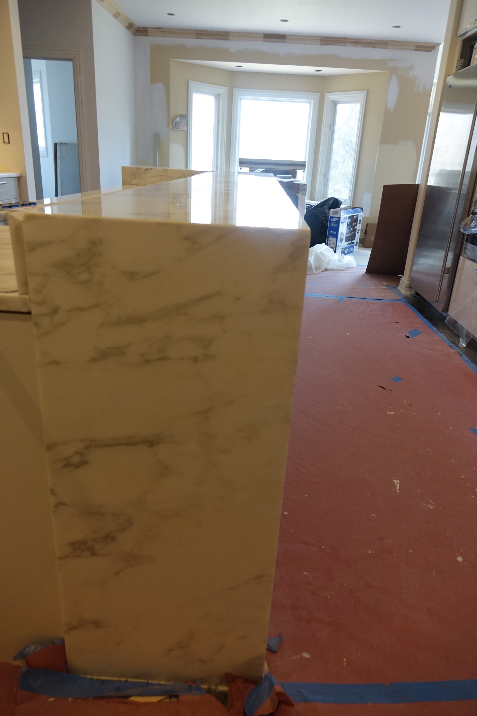

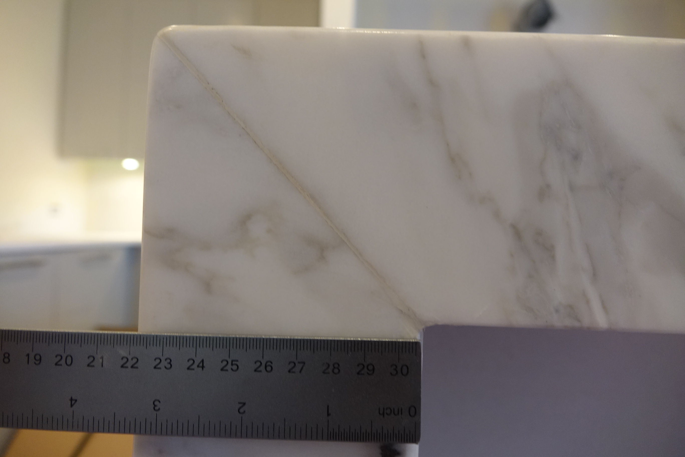

Not that I'm defending anything but to compare a bookmatched seam of some typhoon type granite to a multiple slab mitered with waterfalls out of expensive white marble is like saying "hey the icing on my cupcake is flawless, it should be the same on your 5tier wedding cake". Frivolous comparison IMO.
Your kitchen is still pretty badass.
That being said, they screwed up. That would never be accepted by my clients. It's a mistake. Insurance may cover employee negligence....

IMO, like Dan said, this fabricator is in over his head. If your seams were tight and properly colored most of your issues would likely disappear. I can't advise on the discount but I like Dan's idea, hire someone very competent to fix the work and you may be surprised at what can be achieved. Perhaps paying to have it fixed first would be better than negotiating the discount up front.

If this was one of my jobs we would be redoing. If they said they we're going to book match then they should have it close not 4omm off. From glue they use they must have little experience with white marble and new processes.

If it were one of our jobs it would have stopped in the shop when the first problem of misalignment occurred. Sure, it's easy to say that when giving an opinion on someone else's work but that is the way we would have handled it to keep it from getting to where it is now. If it got to this point with us we would be looking at starting over if needed to correct it. Some here will agree with this and some won't. This is not the worst job I have ever seen in spite of the issues listed. But if I wouldn't accept it in my own home I wouldn't expect my customer to accept it in theirs. We take a lot of risks in this business that customers are unaware of. Most of the time all goes well. Every now and then, it goes bad. Really bad.

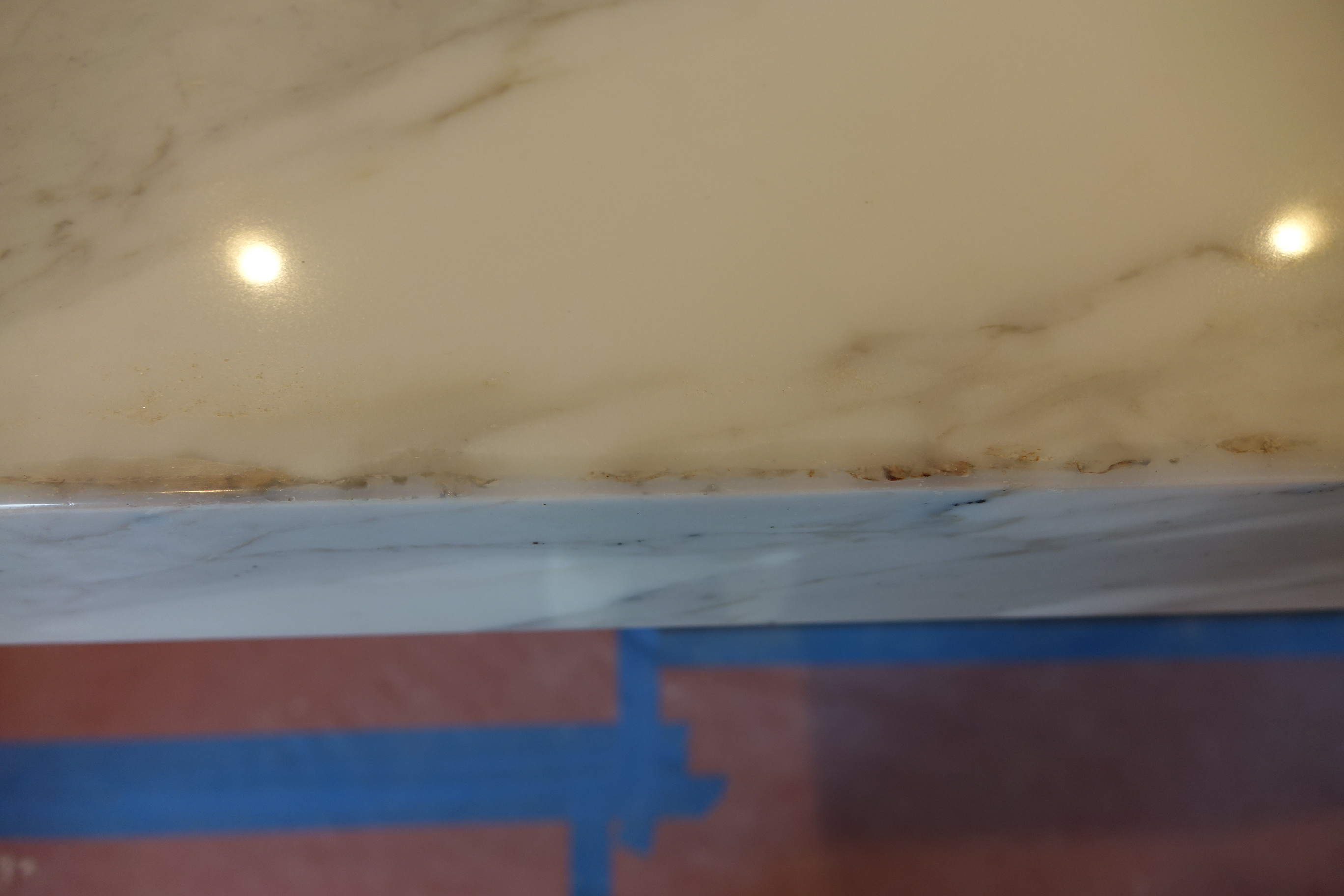

On jobs like this using materials like these we always factor an extra slab into the price. If we don't need it, great. If we do then we are covered. As soon as the problems with the book matching were seen we would have bought another slab in order to correct it. That being said, there are many issues here past the book matching of the slabs. Trying to remedy the issues here as a third part is a no-win situation. Would never put myself in the position of trying to correct someone else's work that the client is so unhappy with. That being said hopefully you can find a middle ground that is acceptable and fair to both parties.

Again -thanks for all the excellent input this has been a great educating experience. As I first stated - I'm trying to be reasonable, and with all my post, trying to be factual and not emotional. Seeing the wide range of responses from other Professional in the business has confirmed to me that this is indeed a tough "grey area" spot I'm in.
So my fabricator is stating that once they got one of the slabs on the cutting board and had a chance to better inspect the stone, they realized one of the corners was "soft" (i'm assuming brittle) and given the veining and what they had to work with, they did the best they could. Unfortunately one of the folks in the shop made a determination to continue without notifying management, who in turn would have notified me. However, given that we utilized almost all the material, they believe it would have been impossible to bookmatch even if they called me, and thus they don't believe they should be responsible for redoing the counter or giving me any significant discount with respect to the bookmatch.
Does for soft corner sound like a reasonable explanation? Because if it does then I'd be a little more sympathetic regarding the proposed discount I mention below.
For a job where the fabrication labor was around $10K they've offered me $2,250 - a number which I didn't hesitate to reject. I feel like they didn't maximize the beauty of the stone as intended (the reason for which I was willing to pay more for the material) and I'm left holding the bag on a project I wouldn't pay even $12K for had I known the result ahead of time.
Thoughts?

As for having someone else redo the work, If I were another fabricator I would understandably be hesitant to finish someone else's job. I'm sure you could agree to no liability or responsibility in the event something went wrong with the fix, but better to let someone else deal with the problem.

Soft corner?
Never heard that term before.
As far as working on other people's work, why not? I am in business to make money. Get a waiver signed, fix as best you can and get paid. Isn't that the goal of being in business?

I'm curious what a soft corner is too. Never heard the term.
Re: Consumer w/ question about faulty install- input appreci
By "soft" i'm interpreting that to mean that part of the material was brittle or possible prone to breaking- as they also stated that they couldn't use all the material without risk of it breaking. I asked them if this wasn't something they could have caught before we did the layout, but they stated that sometime weakness in the material are not possible to detect until its on the cutting board?
Putting aside semantics, does this sound like BS?

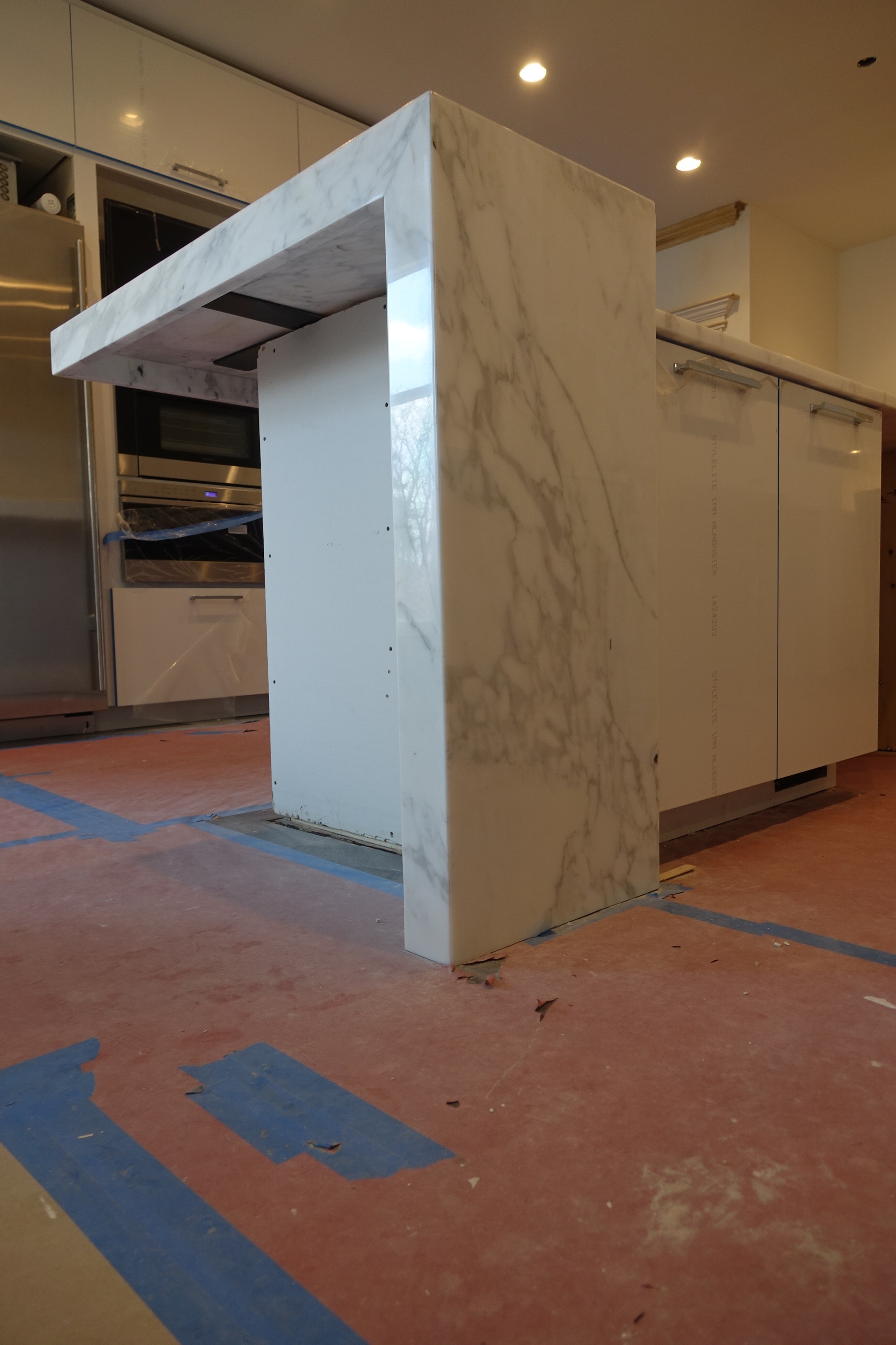

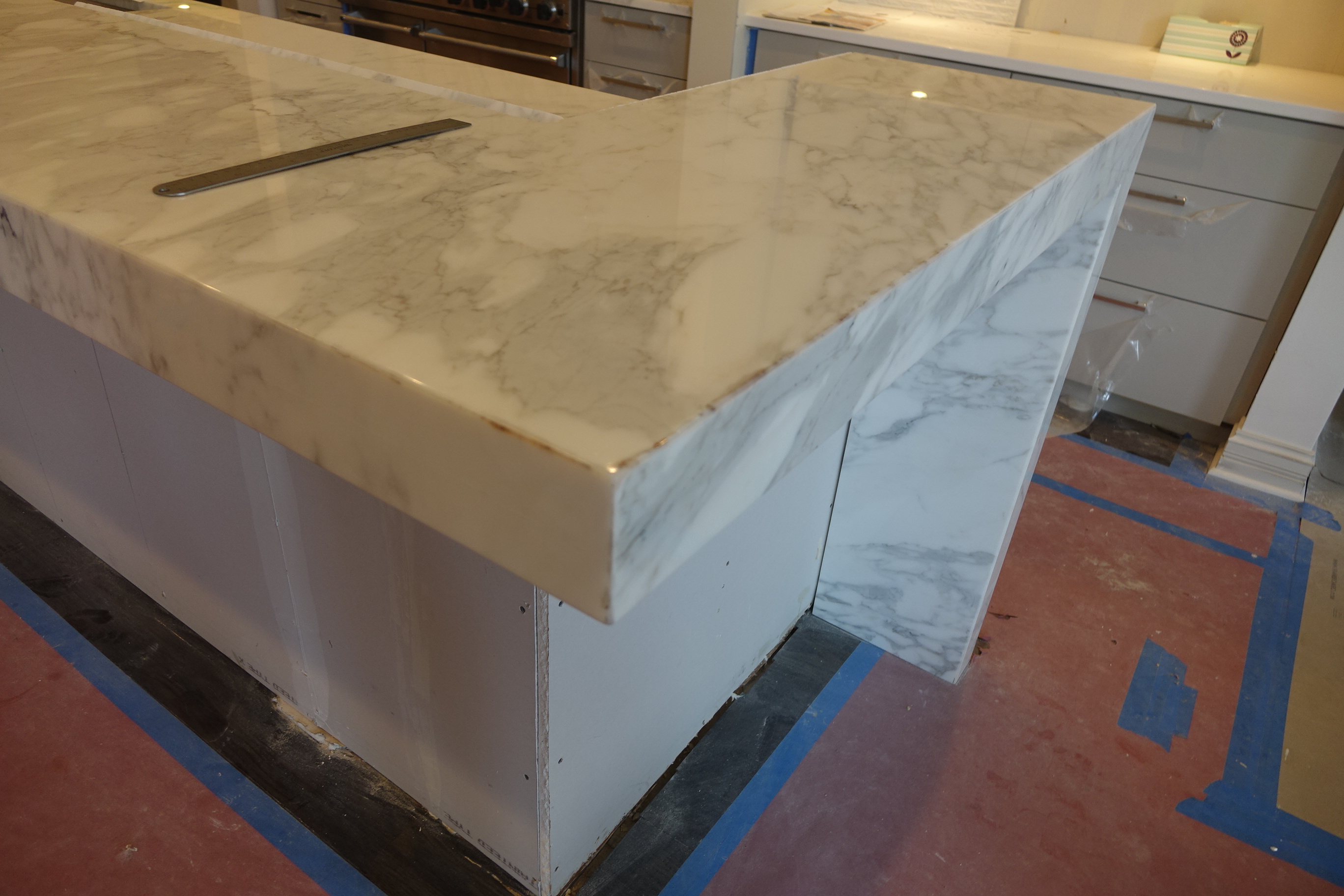

Can you post some more pictures of the counter? Are there cabinets on the other side of the upper island level? Whats the over hang from the cabinets? Whats the thickness of the drywall on the knee wall? Can you show a picture of the two splashes?
From looking at it it maybe possible to shift the right piece forward about 1 1/8 and cut off the the front edge. The gap in back would be covered by the splash.The left piece could be shifted back or the back cut off the thickness of the drywall. Cabinets would need to be deinstalled and the drywall taken off off so cabinets can butt up against the stud to maintain the overhang in front. This would even out the book match. As far as the splash need more pics.

I am interpreting soft corner as a brittle or broken corner where the alignment pins are for their cutting solution. Some machine use a 3 point alignment system that works in conjunction with 3 points on the photo frame they are using for slabsmith. If when the machine operator loaded the slab on the table and broken the corner where the alignment pin was and just shifted the material over slightly that can easily explain the mistake at the source. At that point had the operator informed his supervisor then the issue could have been brought to everyone's attention to try and come up with a work around.
That in itself doesn't guarantee satisfaction but it does stop the "surprise" factor at installation.

ThisDavidL wrote:I am interpreting soft corner as a brittle or broken corner where the alignment pins are for their cutting solution. Some machine use a 3 point alignment system that works in conjunction with 3 points on the photo frame they are using for slabsmith. If when the machine operator loaded the slab on the table and broken the corner where the alignment pin was and just shifted the material over slightly that can easily explain the mistake at the source. At that point had the operator informed his supervisor then the issue could have been brought to everyone's attention to try and come up with a work around.
Happens alot with use. Some issue with the slab dont show themselves until the slab is horizontal. Especially the bottom corners because they tend to get abused while moving the slabs.
I'm assuming the saw man shifted the cut line and hit cycle start. Not thinking about vein match.
legit excuse IMO

Please post more pictures of the complete job so we can see everything and not just the vein match.

As requested. My caveat is that I asked them to stop work once the backsplash and book match issues were spotted, and of course no post install work has been done. So please keep in mind to the extent some of these details can be fixed. I will say that a number of the mitered edges look "dirty"

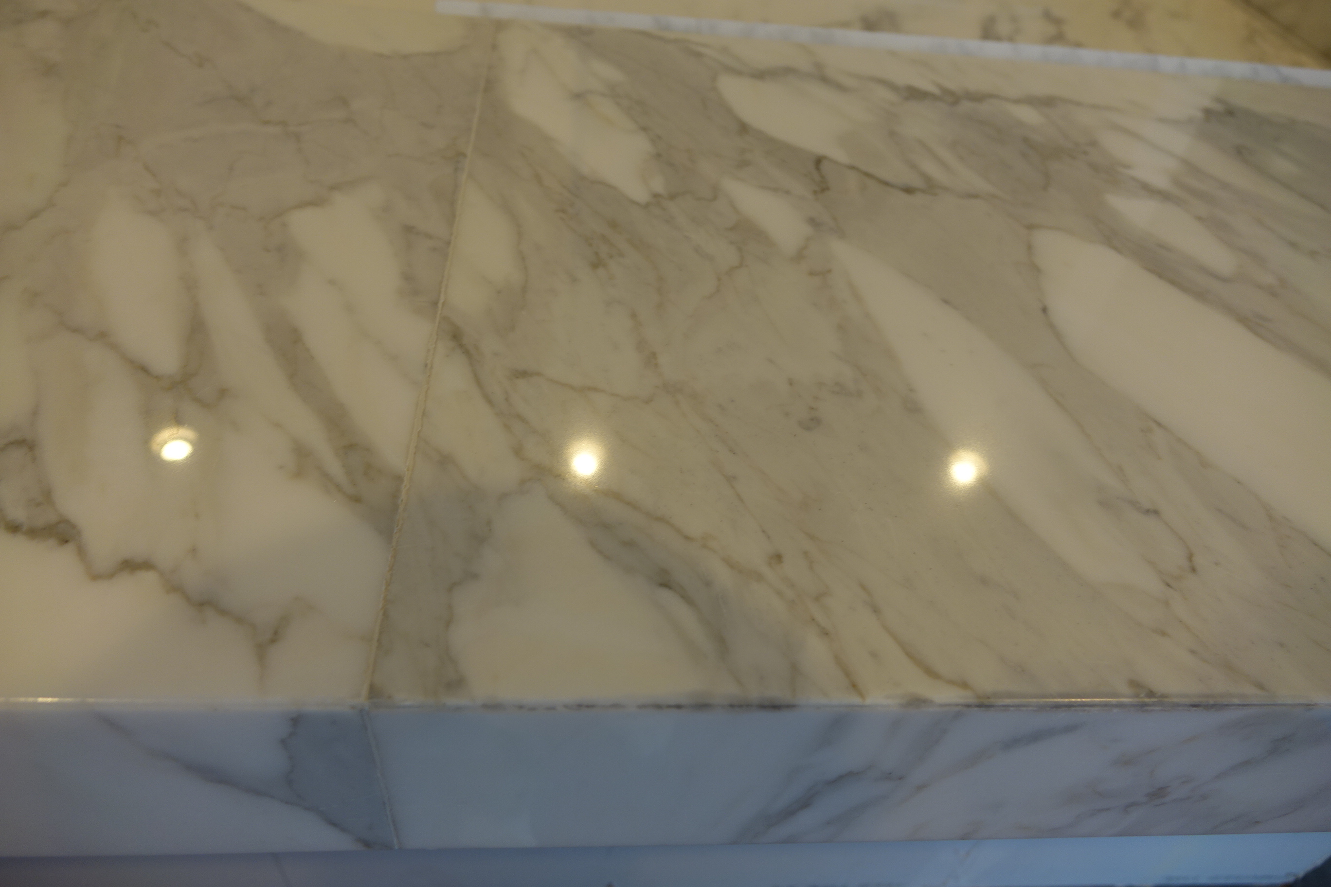

3 slabs - in total the project was $22K (including the perimeter which is a white quartz that I have no complaints about). The Calacatta Gold portion of the project came out to just under $18K.
BTW this is the seam for the white quartz material. From what I can tell its fine. I asked why the same couldn't be done with the marble, and was told that it wasn't possible due to how the material cut.

After seeing the latest set of photos, I have to agree with Alex on this one; a customer of mine would never accept that kind of workmanship in their kitchen.Alex DiPietro wrote:Not that I'm defending anything but to compare a bookmatched seam of some typhoon type granite to a multiple slab mitered with waterfalls out of expensive white marble is like saying "hey the icing on my cupcake is flawless, it should be the same on your 5tier wedding cake". Frivolous comparison IMO.
