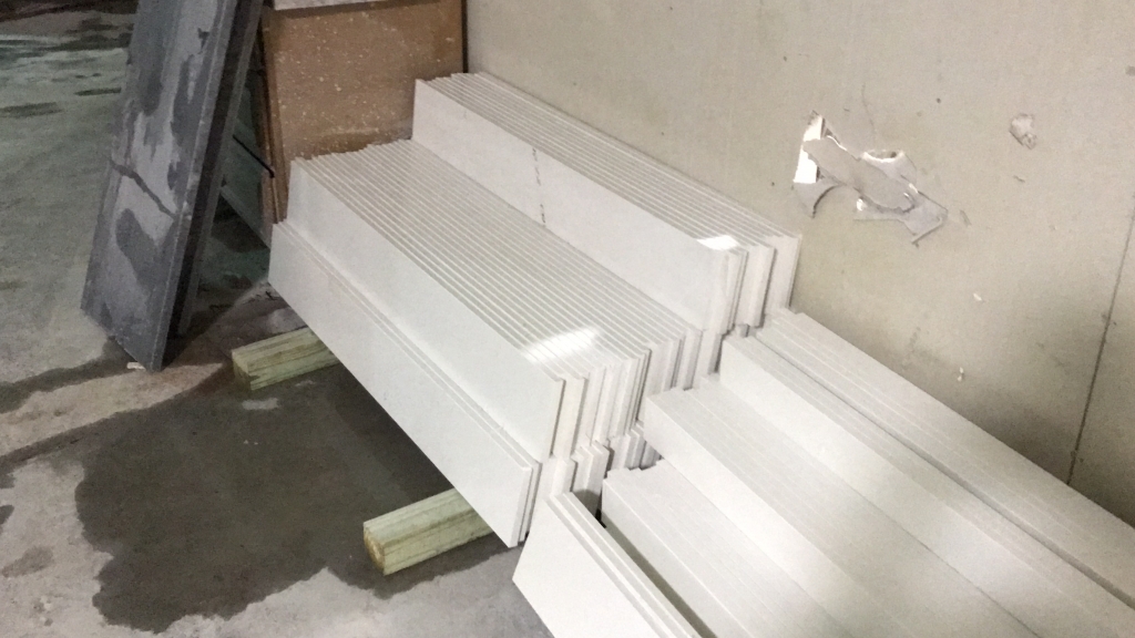

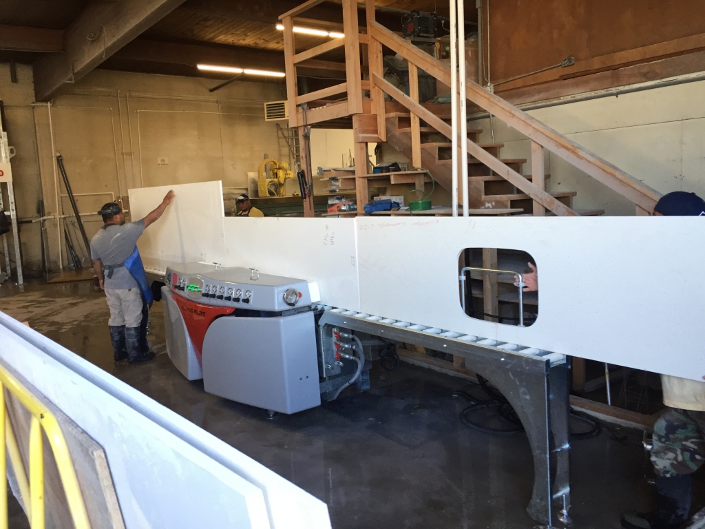

We just had marmo 711 installed last WednesdayAlex DiPietro wrote:We have a new Marmo 711VO. Honestly I think I may have made a mistake with this machine. While it is great when its working correctly, it seems to constantly have issues as we move from quartz to granite to marble. We seem to be having the most problems with quartz. Sometimes 1/4" Of the sawn edge doesnt' get polished, despite having perfectly square cuts. Also, the ends of pieces often need to be touched up.
Since then we did over 2000lnft of edge on quartz no problems
When they installed the machine we had the same feeling thatvit was leaving marks on in and out
The trick is simple run only 120grit to 1800 and bevelers, and turn off 60 and lux
