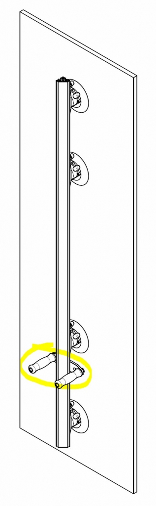

I know this is not answering your original question, but it could be helpful.
If those pieces are 2cm, they will probably weigh over 500 pounds. We are about to release a new handle for our vacuum cup Sink Hole Savers for lifting wall slabs vertically. If you think this might be helpful, give me a call!

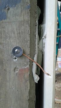

We would anchor using a good modified thinset and tie in with wire. If there is mesh on the back it must be removed. We are wrapping up a 16 slab fireplace right now. Thinset and wire.

Nothing wrong with copper wire.

Depending on the situation we might do copper wire anchors and plaster and add spot sets of thinset or Rivo/Latapoxy 310.

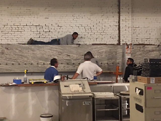

+1 for adhesives plus anchors. We have our Keep-nut anchoring system, which will work whether the slab is 2cm or 3cm. These are very strong blind anchors that are easy to install. Here is a photo of a job one of my customers recently did. This a large stone panel that will have beer taps mounted to it at a bar.
We also have some very strong industrial epoxies that would work great. If the mechanical anchors are doing most of the work, you could go with a flexible 1 part adhesive. Our MS35 adhesive is 3x stronger than silicone and will not stain natural stone like some urethanes do.
Let me know if you want any more information on this. Hope this helps.
