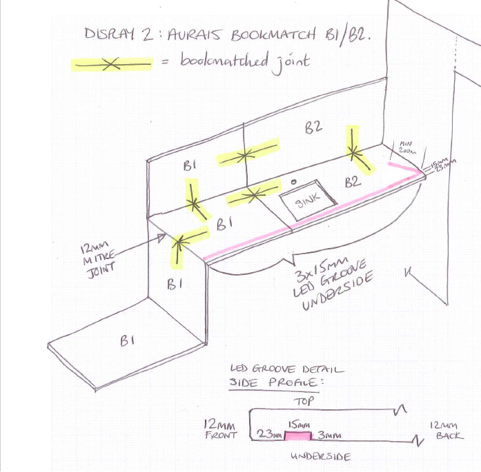

Hi guys
We have a had a request from a customer wanting a LED Groove on the underside of Dekton. 3mm deep 15mm wide.
My CNC is a Intermac Master 53, our CNC Saw is a GMM. we don't have any problems fabricating dekton usually but as we all know on here you cant plunge cut the stuff.
has anyone on here achieved this before? please see drawing for a better description.
Need advice on what tooling ETC to use

You would not be plung cutting it if you flipped the piece and ran your saw 3mm deep from one side of the top to the other?
Or you could just use what ever you rod with to cut a grove in the bottom side of the slab if you worried about too much tension with the saw while cutting.

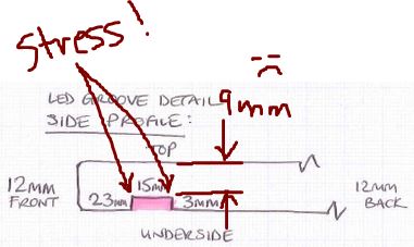

Hi Sam, welcome to the forum.
I am not a fabricator, and I have no practical experience with Dekton, so take this with a grain of salt.
This does not look like a good idea to me.
There is less than 3/8" left on the whole front edge. The sharp corners in the bottom of the groove will create high stress concentration points (this is a fact). As far as I know, Dekton doesn't play well with areas of high stress concentration.
Just like having sharp inside corners on a sink or cooktop cutout, the sharper the corner, the higher the stress concentration. That whole area in front of that sink cutout looks like it is just waiting to blow up to me.
It is almost like you would be scoring it (like they score glass or porcelain) so it will snap right there when someone leans on the front of the countertop.

A safer option would be to put the LED strip under the cabinet in front of the toe kick. Still looks cool, but doesn't destroy the structural integrity of the very expensive countertop.
- Posts:1725
Re: Advice on Dekton please
I know this would change some of your detail and add labor but just giving another option if your worried about the stress points as Larry is describing.

I did not notice that you are using 12mm material, I assumed 2cm.
I would also not do it.
I like Rick George's solution.
I think the 12mm material makes this too risky. I also think that Rick has given you a viable solution as well.
I wouldn't do this with this material thickness.
2cm or 20mm would be ok.
Like Nick said you aren't plunge cutting this.

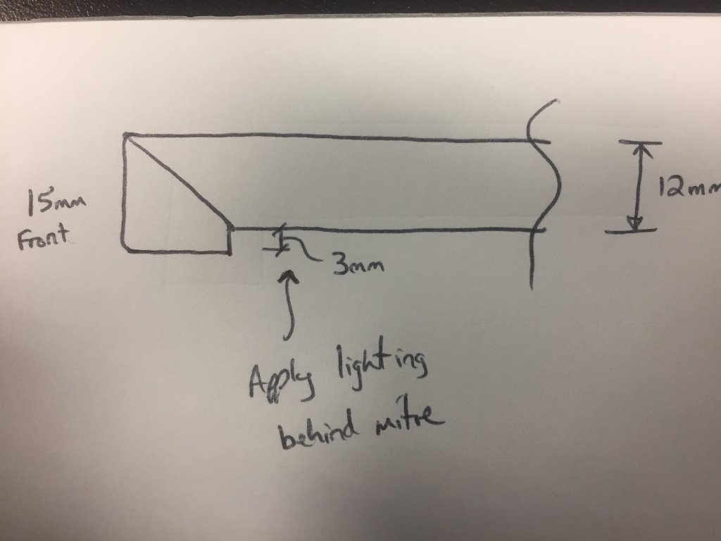

I would also say no. I don't care what the people who produce the material have said, are they doing it? The only way I'd try it is to have them send an extra slab for free when it does break.
I would also agree up above that the only real way to do this is to miter the edge and just tuck it behind.

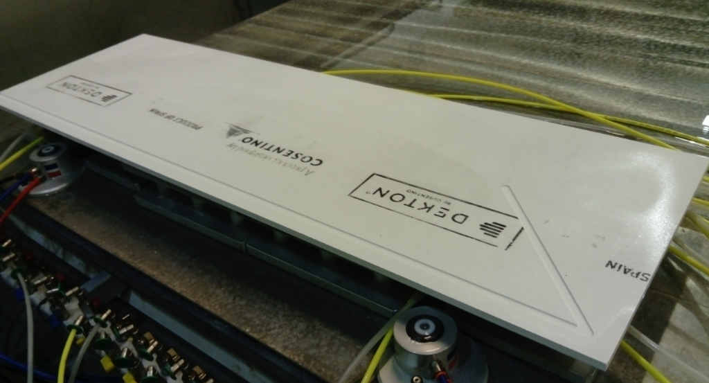

Been Doing some trials on a scrap piece of 12mm this morning,

It looks pretty good. Does it seem strong when you lean some weight on it? Be careful not to get hurt.
From an engineering standpoint... If you can grind your finger bit with at least a small radius on the end, it will greatly reduce the stress concentration at the corners. And if you could even polish those tiny corners a little, that would really help too.
it seems really strong for what i was expecting, tried everything to get it to snap under normal conditions and it stayed strong, i wouldn't want to chance going any deeper than 3mm deep though.
however the job requires a cut out which could change everything, i will be doing a cut out later on this peice this week time permitting.
