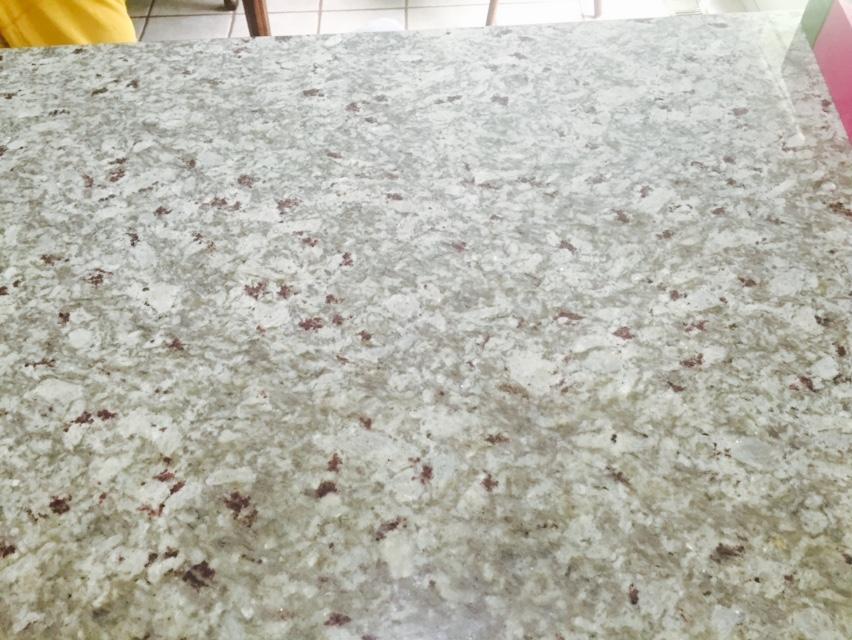

Do you have any pictures? That would help a lot

See attached. Hard to see but on the pic that's further out, the bottom portion is darker than the remainder. It should all be lighter like the top of the pic.
On smaller pic, you can make out the darker stained area a bit better.
