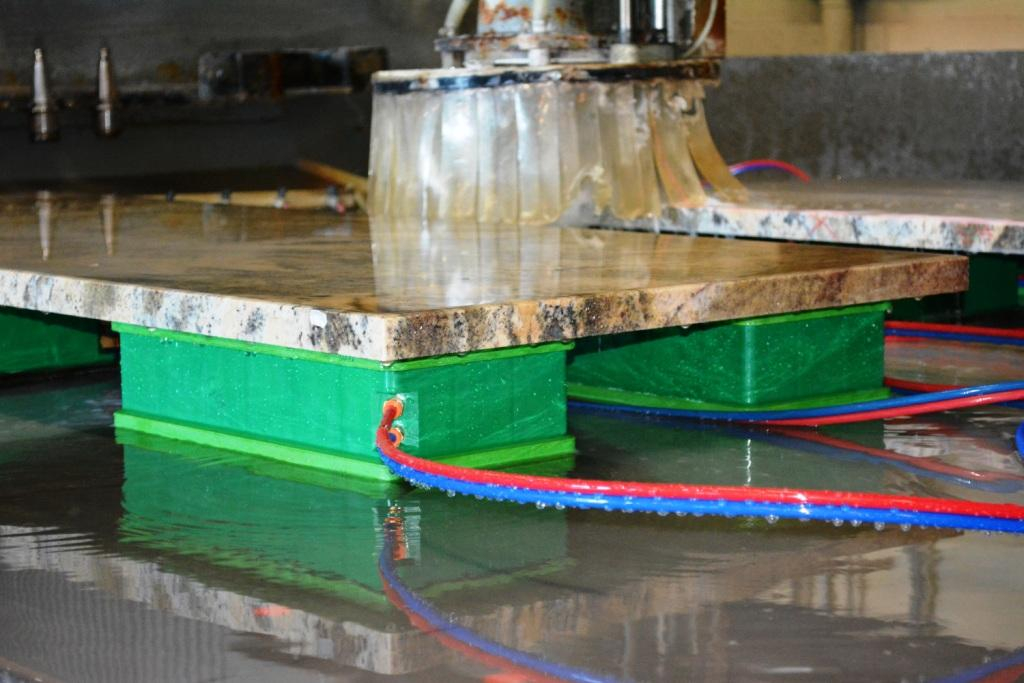

But i had a customer that had the same problem and switched to the Helix pods and no issue.
- 200X400.JPG (492.21KiB)Viewed 1779 times
- Another reason the customer switched to Helix Pods
- 50111892211__CF52A555-8D2A-4A12-89A1-172656E6F7E7.JPG (607.62KiB)Viewed 1779 times

One more reason I like running face up on the new router!
Like Todd, we use softscrub when we get them on the old router.
- Posts:685
- Location:South Jersey
- Been thanked: 36 times
Re: Pod marks on Quartz
Face up! Joe, how does the machine put out a consistent edge on different pieces? Does it probe the surface so the bit is indicated from the top so the edge is uniform across different parts?

That's awesome Joe, but German engineering needs to figure out how to set the rapid plane and z plane lower so it doesn't take an hour to measure a vanity top.
That was actually a test of me seeing how often to probe. It was set to probe every 50mm (2" in freedom units). I now have it set to probe every 200mm (8" in freedom unit) and it takes less than a minute per sink.

My pods have foam seals that are about 1/2" thick that compress. Never had a problem with any type of back.

In regards to stone that has mesh backing its still not an issue. The vacuum still holds because of the foam seal around the top of the pods. Also our with our cnc's (All Prussianis) we have the clamps that also help to hold the stone down even more.
