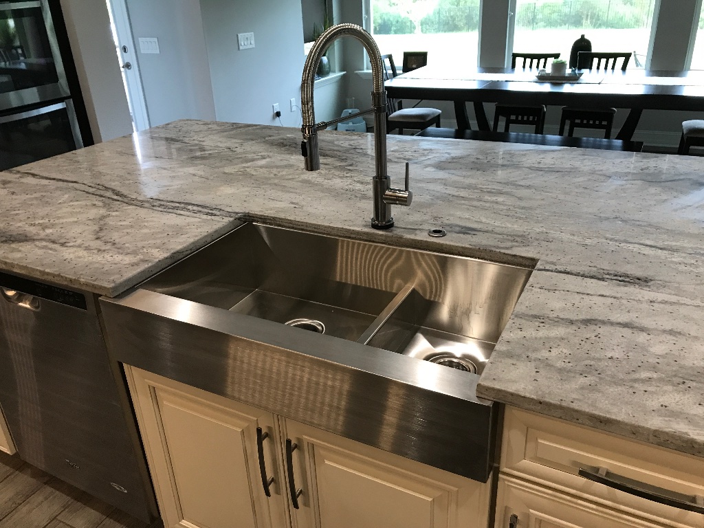

Hello,
I'm very new to the forum so I apologize if I do anything strangely.
My family owns a countertop company. We have been in business for 40 years and are a multi-million dollar company. A few years ago I convinced everyone we needed to get into stone work. Being a laminate and solid surface (corian) company before I warned them that much of our previous knowledge will not be applicable as stone is a very intricate material to work with. Turned out to be more so than i even imagined.
We have managed to do decent for ourselves and our stone department has really started to take off. However, we are having trouble with a few colors. I have been told by many people that colors like Uba Tuba are just awful and tend to break for no reason. Which is also our experience. But i have no heard much about these colors below.
The colors in colors in question are Colonial White and White Valley in particular. We were hoping to stock these colors but have had problems.
We had a standard 4" 3cm splash in the colonial white. They were carrying the splash upright and correct and it broke out of nowhere. We even put a "sink saver" on it (see link) and it broke WITH THE SINK SAVER.
https://i.imgur.com/pMm4Wko.jpg
We got in 3 slabs of White Valley and it was riddled with fissures and cracksn (see attached pictures). The bigger ones you can feel but some are inside the stone and cant be felt. I don't know how people can accurately bid jobs with this material as it seems like you would have no idea how you can get your yield out of the material. All three slabs were like this.
Our stone provider is a national company and has a high reputation. I find it hard to believe it would be the fault of the distributor.
Looking for advice on these colors or colors like them. Do you just big them accounting for extra slabs every time or is there something we can do or should be doing with troublesome colors.
