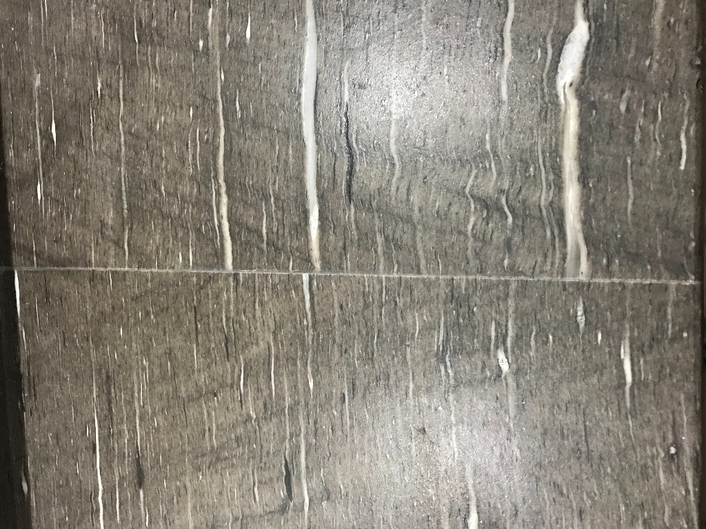

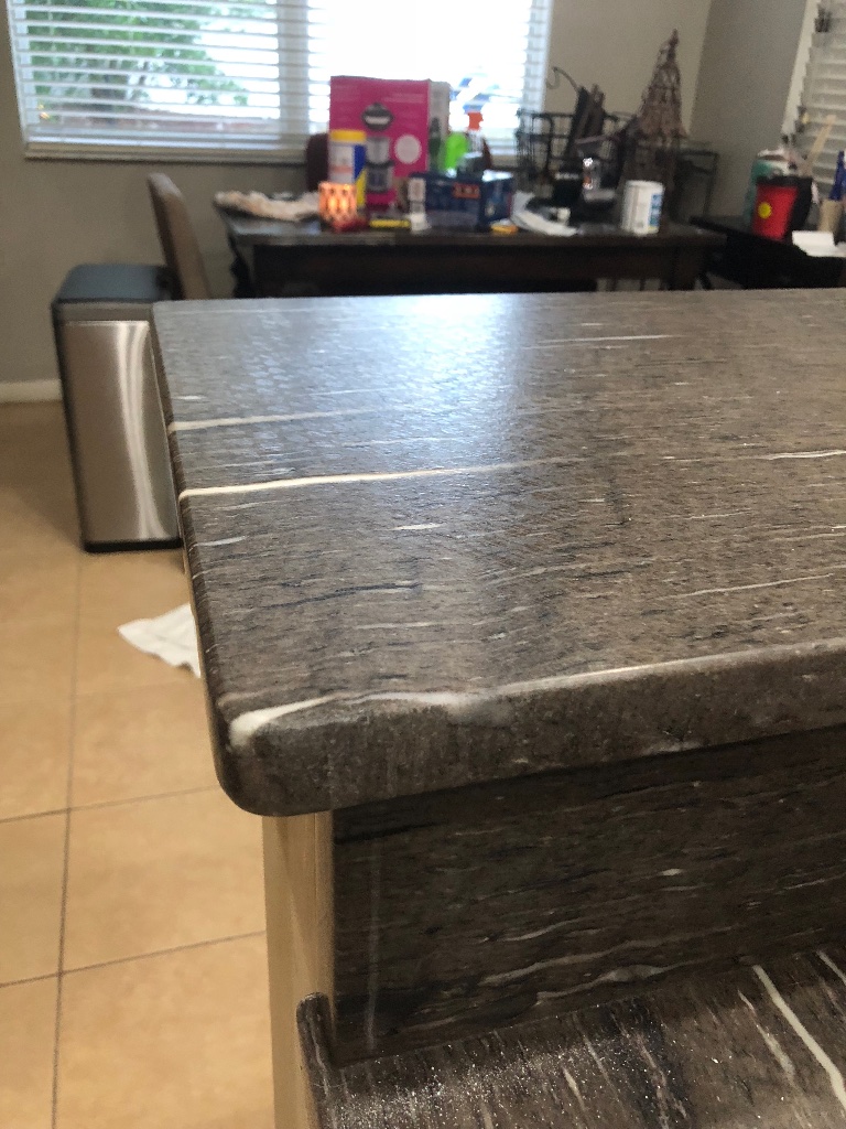

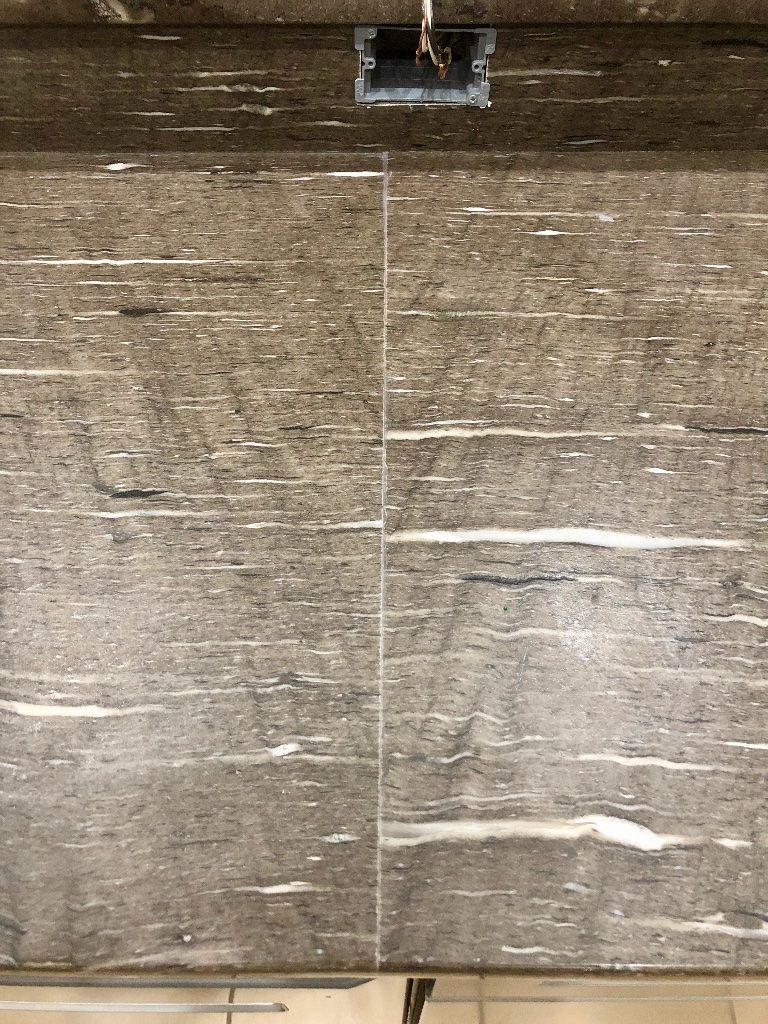

Just this Tuesday my husband and I had Cygnus Leathered Quartzite installed in our home. However it all very quickly went awry...
We had to have multiple seams in our peninsula/breakfast bar space due to lack of material according to our installer. I was made aware of this well ahead of time and completely fine with multiple seams and was assured they would look excellent. Okay...moving forward... we have 6 seams in our breakfast bar and all of them are pretty good...nothing pristine but nothing particularly offensive except for one really horrible one right in the middle of everything. It is completely uneven with a huge lip. The installer is stating it’s the best he could do because we have a bowed slab...which I don’t really believe because I feel like he could have notified me it was defective prior to fabrication?
I digress and I’m sure I’m rambling...besides the horrible seam there is this very odd pattern all over the slab that he claims is permanent and will never be removed...is this true?? Part of my kitchen has a beautiful satin/matte leathered finish and the other parts have this hideous speckling...
Help please I’m desperate to figure out how to fix this mess!! My husband and I spent a great deal of money on these slabs and really don’t want to be left with a ruined kitchen that we are working so hard on...
Thank you all so much for any insight and help you can offer we truly appreciate it!

First off, breathe. Beautiful material & it is all fixable.
1. The bowed slabs, sometimes (usually) this is not evident until slabs are seamed together. A slight bow can really look horrible. This can be fixed by by smoothing the seam and re leathering it.
2. The seam would benefit from a better glue match.
3. The speckling can also be removed by some finishing work. This speckling looks to be some pattern transfer from shipping and storage.
Have your fabricator visit our site and ask for methods to rectify these situations.
Perhaps a local member could offer some assistance.
All can be salvaged, with a good story to tell in the future.

I do not believe that Cygnus is a quartzite, could be wrong.
I see an issue with the finish unless it is a fluke.
Cygnus/Aspen will fade in sunlight.
The seam, to me, is unacceptable.

you need to call around and ask other fabricators if they work with leathered/textured material and if they have the capability to repair the FACE.
If they are refusing to do more work it is more than likely there not comfortable doing it.
Most fabricators dont like to work on others work.
as others have said this is repairable.
the grain direction between the upper and lower???CRAZY

grain difference could be a yield issue.

Bowed or warped material is common and there are tools and/or techniques to deal with that. Many times you won't know how bad it really is till you dry fit the pieces. Sometimes it is bad enough that, even with the proper tools, some lippage is unavoidable and the only way to eliminate it is top polishing, then in your case re-leathering.
There is a chance someone could separate that seam and start over again with gorilla grips or our Stealth Seamer and force that warp out without having to take down the surface.
Adding seams because the counters were so long? That could be true because of yield, but hopefully they didn't just make them shorter to keep them from breaking (ie. pre-break them). How long were your countertops?

Here's what I'm rambling about: Seam before. Seam after. Funky imprint stuff; looks like someone stacked the finished sheet against the back of something. Funky imprint stuff on the top half of the bar; removed from the bottom corner without altering the suede finish.

Looks like you just colored in the seam with a sharpie or
, why the mess you have all over the stone around the seam... but then again you are the sharpie king.

No sharpie or oil was used, thank you very much. There is no bleeding, you're seeing things. She was so delighted with this freebie she even gave me a little gas money tip.
