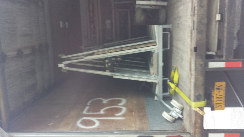

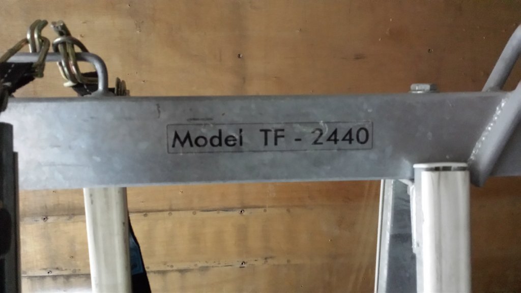

Hey Jeremy. We have been using these racks for about 2 years now. We load racks with vacuum lifters that would easily hang from your job crane. The racks have fork pockets on all sides. Minimum 42" long fork for loading from the short side. They come with 2 fixed wheels in the front and a wheeled handle (dolly) for moving the rack by hand. As seen in the attached photo, we ratchet strap the rack in place to keep it honest. It can be run as a one person operation until you get to the jobsite. Hope that helps.
