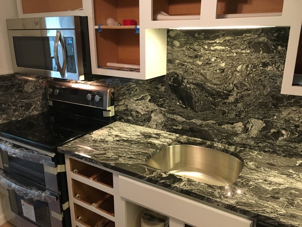

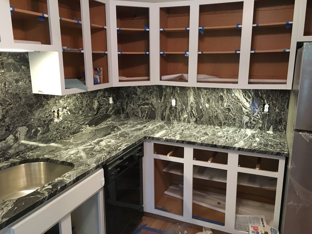

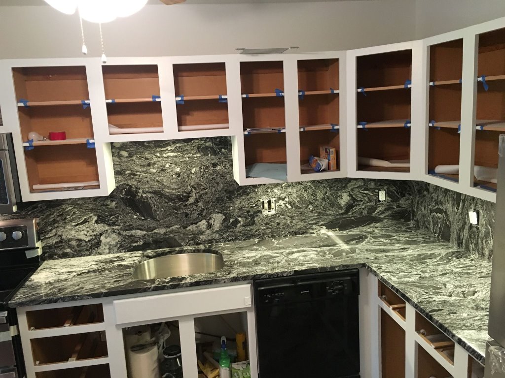

No excuse. This is an example, not perfect but over an hour of planning to cut this entire job from one slab. Every customer deserves your best effort.

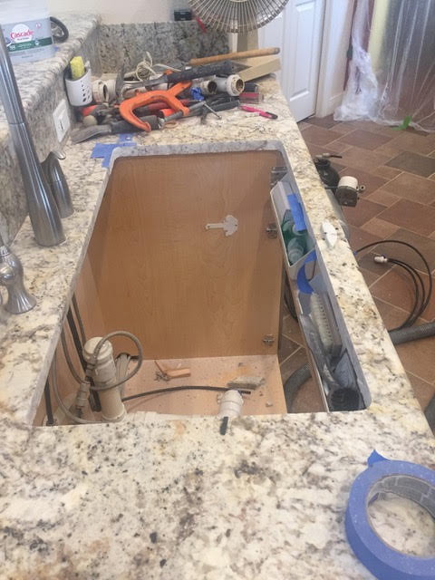

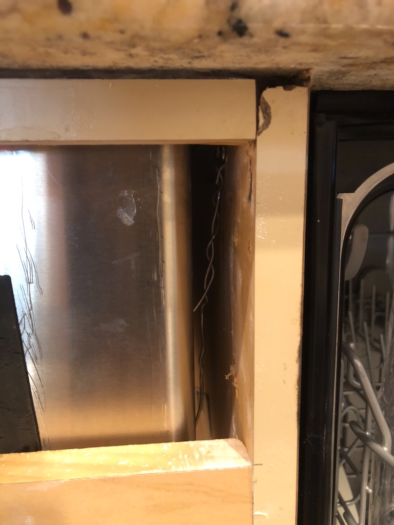

Celtic Granite:
Very impressive work.

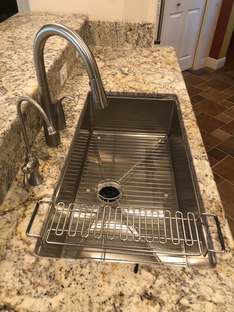

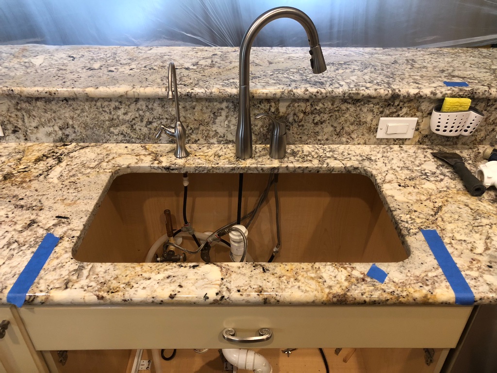

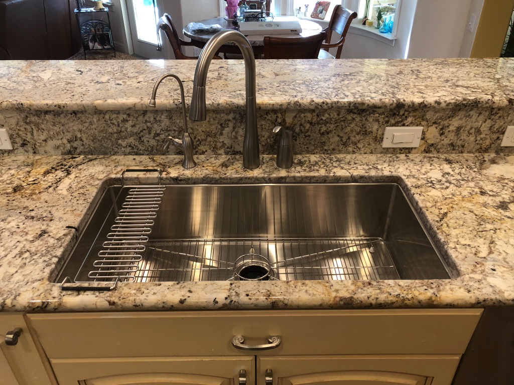

If I may, I'd suggest strapping your sink in place next time. This eliminates the need for for a front rail wide enough to accommodate sink clips. If you rabbet the 3/4" cabinet top rail by 5/8" to accommodate the sink flange, with a 1 1/2" overhang, the front rail would only have to be 2 3/4" or so depending on reveal. The saved 1 1/4" might let the plumber put the faucet in the center rear of that sink instead off to the side where it has to go now.
Hercules Universal Sink Harness @ Braxton Bragg, and/or Sink Strap @ Regent Stone Products.
Re: Granite seam quality
Just like Kohler specifies in their instructions, a 36" sink going into a 36" cabinet is going to require some cabinet alterations. You're essentially replacing the cabinet you're removing with stainless steel when you strap. Yeah, so I chewed up the laminate face of the cabinet making the slot for the sink flange to slide in, but it gets covered by the drawer front that's never getting opened again anyway. You can see the wires of the Hercules Universal Sink Harness (Braxton Bragg) in the picture. You're not doing this retrofit without it or a couple Sink Straps (Regent Stone Products).
I think I'm gonna make "Three K in one day" my new motto.
