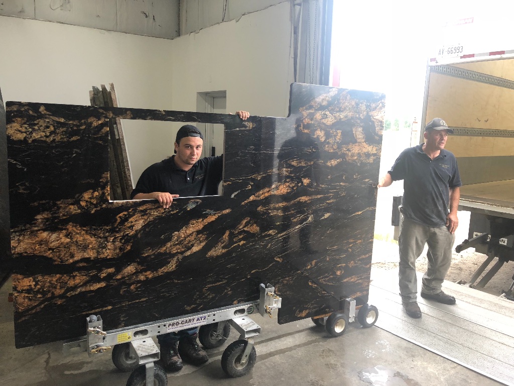

This was a fun one!
- 5CB94386-91A7-4DCD-9E04-644E8E35DAB5.jpeg (297.61KiB)Viewed 852 times
