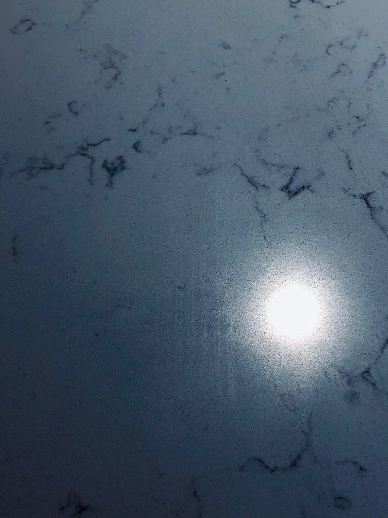

It was hard to get a photo but this is what we call aspen White - nice white with a hint of marbling.
It looks like rub from the A-frame straps EXCEPT it runs the LONG way.
Anyone have an idea of what this might be?

It looks like a marking from a transport rack with a rubber protector on the horizontal supports. I don't see anything in the first picture, but the rib marks in the second one looks like a few other photos posted here in the past. Was that piece transported face to frame by chance?
Re: Quartz Defect
One of the 3 Quartz Renew liquids usually takes those marks out. I buy it through Regent Products but Jim Lang (owner/inventor of quartz renew) would look at the pics and tell you exactly the steps to take.
