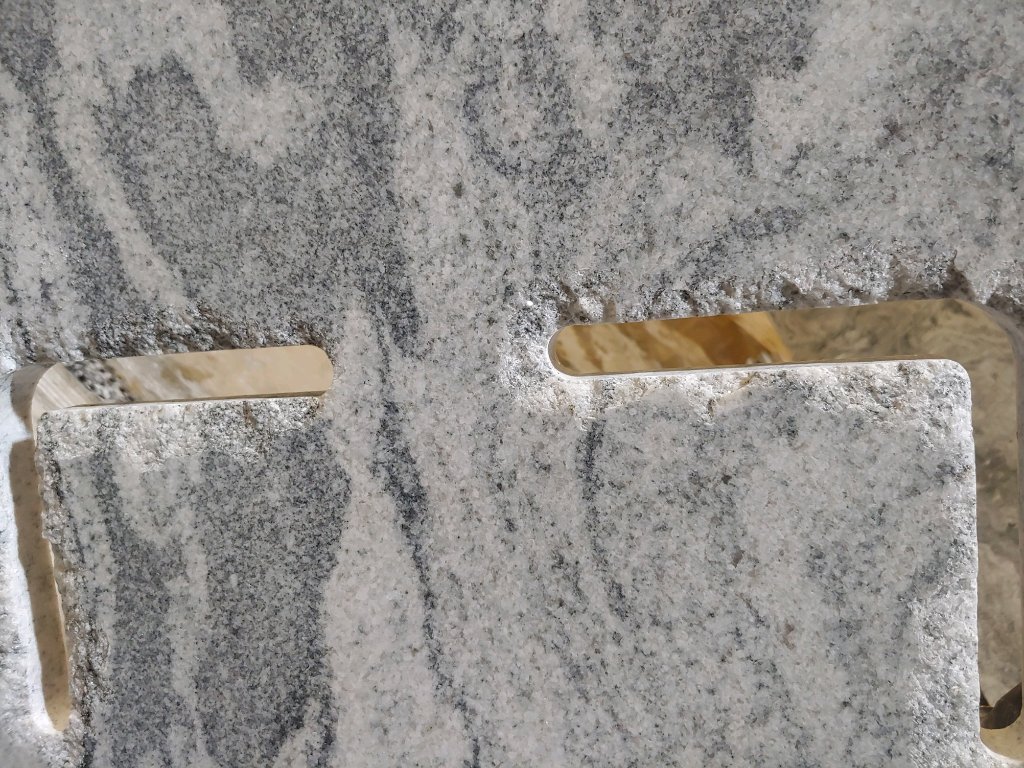

Re: 5 axis incremental bit
My latest blowout on viscount white,
Apexx blue bit 20 x 20
RPM 4500
Feedrate 15 ipm
Depth rate .04 ipm
Does anyone have any suggestions. i just can't figure out why i'm getting blowouts this bad? Are my setting bad? or is viscount white bad material. Any help would be appreciated?
Hi Everyone,
I think it's working. Apexx white bit seems to be the key. First time with no blowouts since i bought the machine ( 2 months) crazy happy right now
White Paradise granite
RPM 4500
Feedrate 24 ipm
step cut .04 ipm
Just wanted to thank everyone with all the advice.
