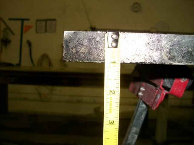

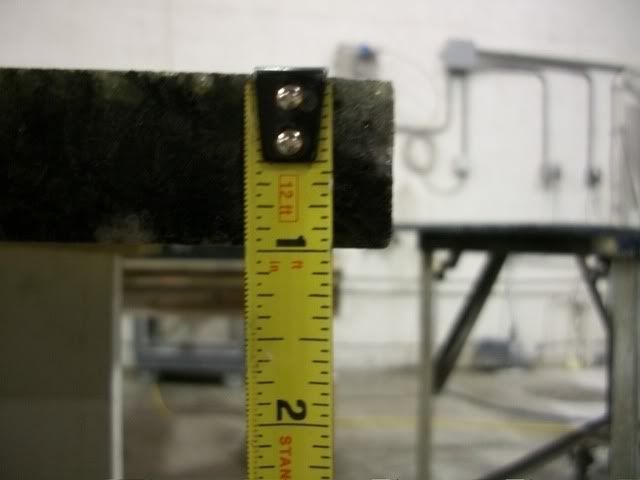

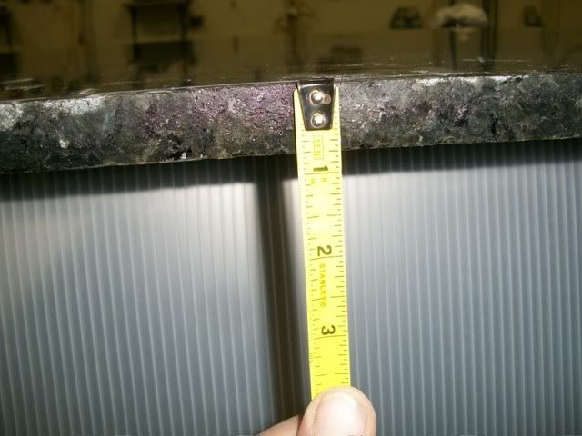

Left side, center, and right side of a 112-inch vanity in Uba Green, a month ago.
Sold as 3cm stone.
Sold as 3cm stone.
