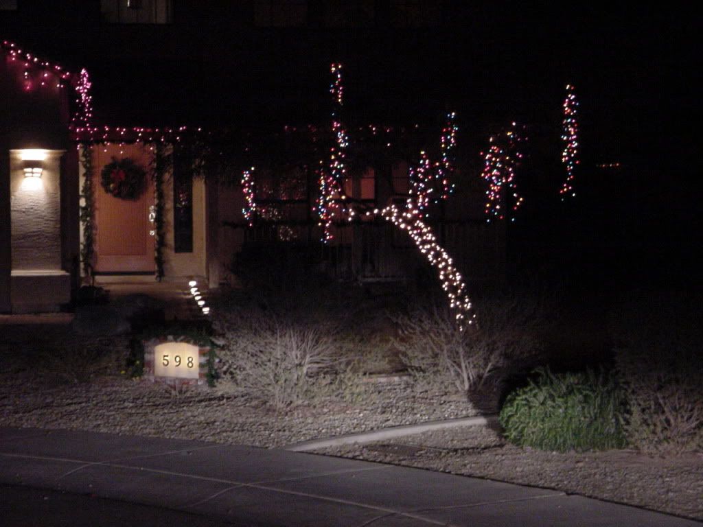

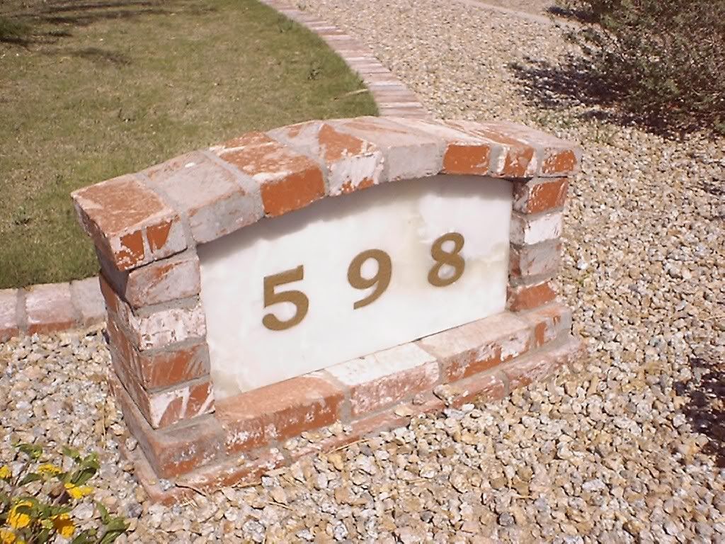

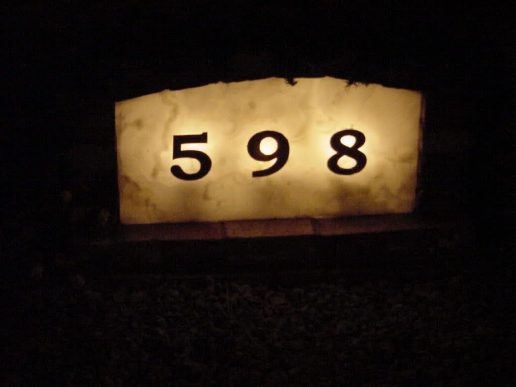

Here's one I did about 14 years ago with some scrap left over from the State Line Casino project in Wendover, Nevada and I used Malibu yard lights to do the backlighting on this one - way before LED's and FiberOptic panels were readily available...
I just put a single Malibu 4 watt low voltage light bulb behind each number - set back from the back of the stone by about 4 inches....I engraved the numbers in the stone with a Dremel & a regular steel ball to give a "hammered" look..... I covered the whole piece (18" x 24") with blue tape, drew on the numbers, cut out the tape where the numbers are, engraved each number, then I spray painted gold on where I had engraved and removed the tape to reveal the finished work...... pretty easy...
House marker by day.....
Beacon by night.....
View from the street at Christmas time.....
I am working on a couple of new designs in the shop - I'll post pics when these new ones are done...
Enjoy!!!

Re: Best method of back lighting onyx
Hey Kevin, What kind of Christmas picture is that - no snow?
