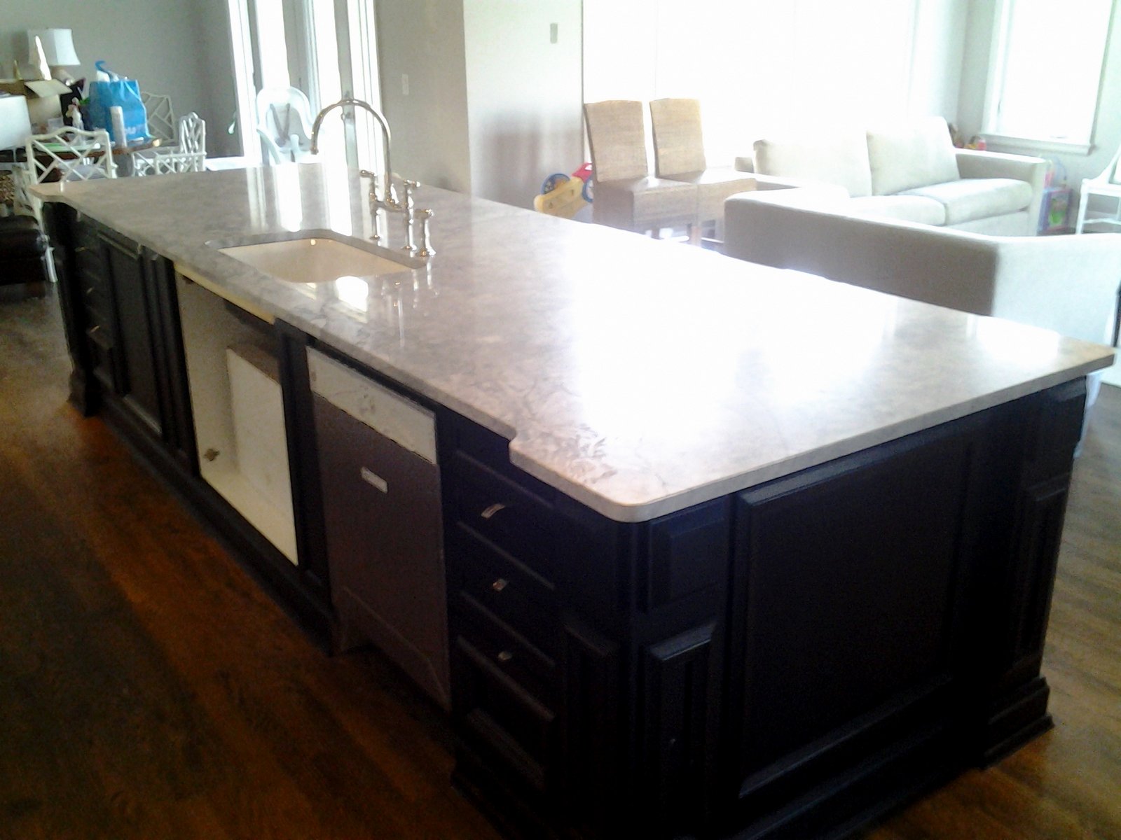

Job finished. Here are a couple pictures. Sorry about the quality, taken from my phone.
13 Foot Island!
13 Foot Island!

Re: Super White
Nice work!

Re: Super White
Are you from Emerald? I have had people asking about a granite company over there. The island looks great!
