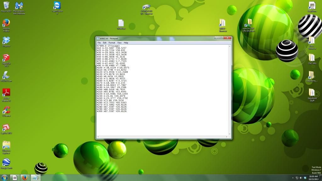

Does anyone know of a quick way to delete all the "N()" in the code below?
I know you can find like words and delete or replace them all at once so it seems like there should be a quick way to delete all the N numbers and just leave the x and Y's. It irritates me that i have to highlight and delete each one individually.
Buddy of mine said to use search and replace with a wildcard. hope this help as i have no idea what hes talking about
He uses notepad in conjunction with our cnc quite often to run multiple parts at the same time.

apparently when i lissage parts, the program generates a N# at the beginning of each line that causes problems with easystone. I asked Omag about it and apperently they cant fix it because my operating system is windows 98. its more of an annoyance than anything, but this "wildcard" trick seems like it will work well when i need it to.
