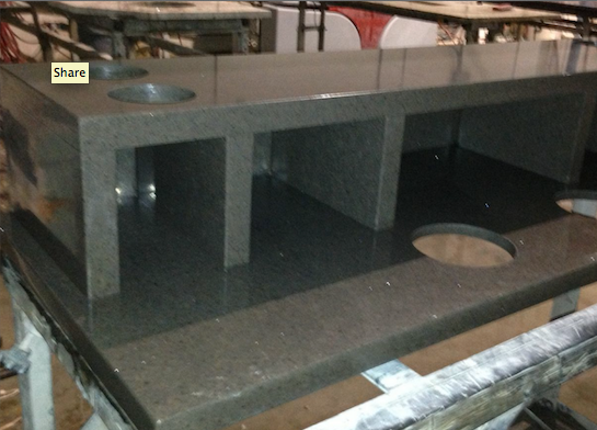

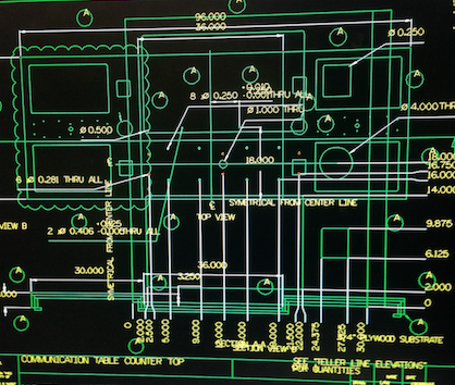

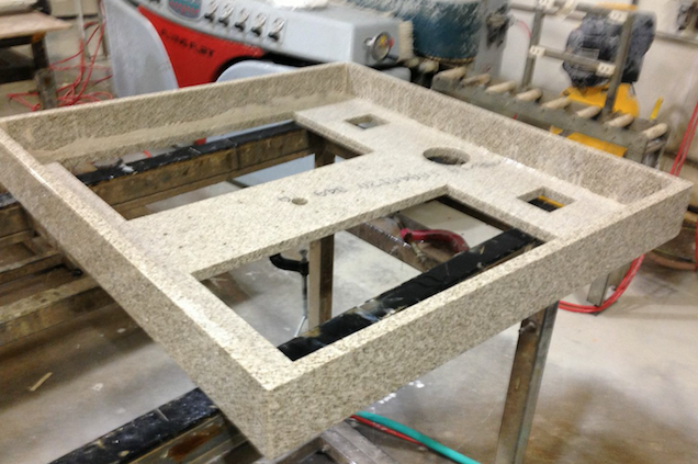

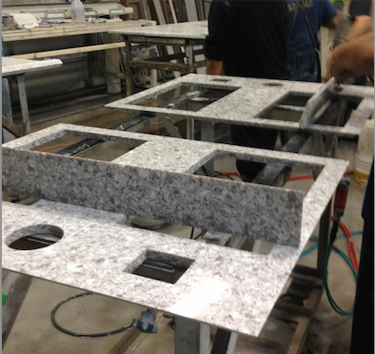

Mitering on a CNC works perfectly and chip free, it does not produce curved miters....you don't have to stop cut the miter and separate the parts with a grinder and then hand miter or double cut the part...A low dollar per hour worker can run the sawjet & CNC router, producing great product without years of experience and weird science.
I am posting a few pics that I took with my phone the last month I was consulting in the shop in Seattle so you can appreciate what I am referring to.
