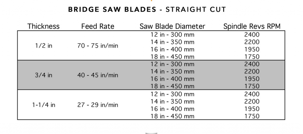

FWIW, here is some helpful information from Terminator:
http://www.terminatordia.com/top-tips-f ... -materials
I also posted this in the How-To sections.
Re: Dekton Fabrication
I have to disagree completely with the suggestion to place 1/2 foam board under a dekton slab. That is of course unless you like flying glass all through your shop and employees.
I also question the feed rates that terminator posted. I have never achieved anwhere near 35 inpermin on Dekton. Highest Ive been able to achieve is 14.

Things to remember with all sinthered products -- Dekton, Lapitec, Neolith
Light colors are harder than darker colors.
We run 2350 rpm @ 25 inches per minute (14-inch blade) on white/light colors
and 2150 rpm @ 40 inch/minute on dark/black colors.
Slow down feed rate on entry and exit of cut.
Listen; the more noise your blade is making the harder it is working.
Relieve stresses by cutting off tension strips long and short edges-- as per manufacturer's recommendations.
Some manufacturers (Lapitec) want you to cut off tension strips on 1 long and 1 short edge, then begin your cut coming in through the rough edge and proceed toward the edge that the tension strip has been removed from.
Place cutouts towards the center of the slab and cut them last.
Drill Core holes on all inside corners of the cutouts before plunge cutting the sides of the cutouts.
