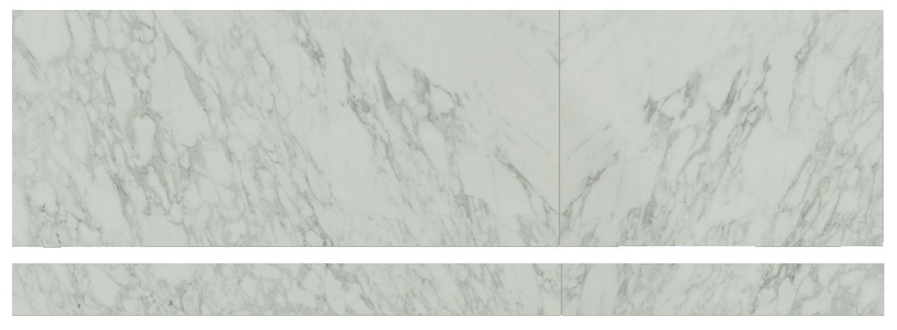

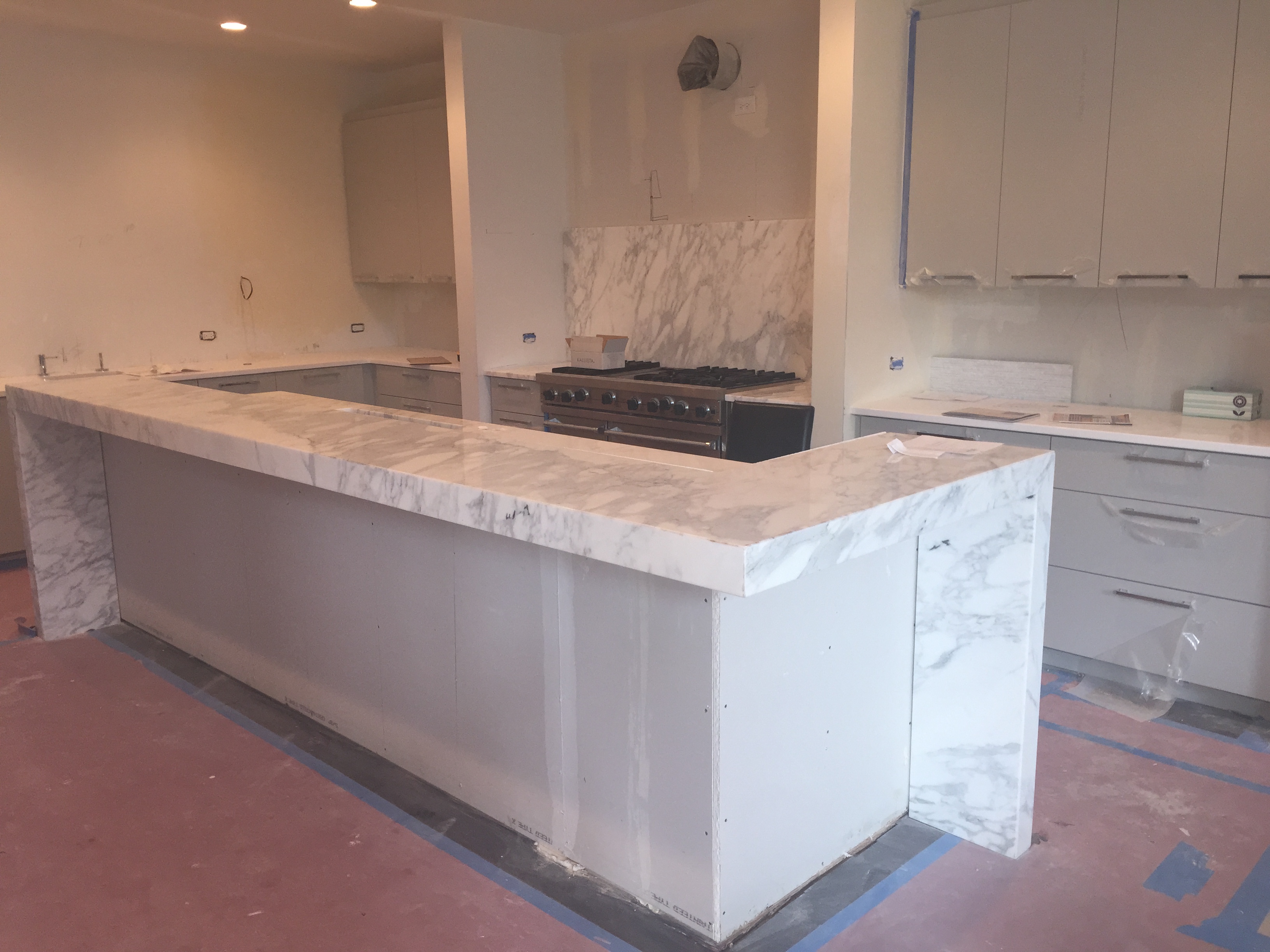

In short, I have a rather large island which is over 15 feet long and with a bar level (ie. 2 levels). I decided to splurge and after a long search found 3 beautiful Calacatta Gold slabs with minimum gold tones. Given the length of my island I made sure to find slabs that were also book matched. My fabricator has a new system they implemented within the past year and instead of taping off the slab, we used a really impressive computer software tool to layout the material - which included the critical book matching of the seams and mitered backsplash. Unfortunately, come installation time there were three issues (i) the countertop was not book-matched as agreed upon in the computer layout ( it was "off" by 2 inches"), (ii) to make matters worse, one of the backsplash pieces was 4 cm short - therefore if left unrepaired the vertical seam would not align with the horizontal seams, and (iii) the seams appear large and jagged (granted fabricator mentioned that post install detailing would need to be done).
I understand the material itself cost $12k from the distributor, and I want to be reasonable consumer, but I'm very frustrated with the results thus far. As a fabricator what would you do to rectify the situation? Is this a common occurrence?

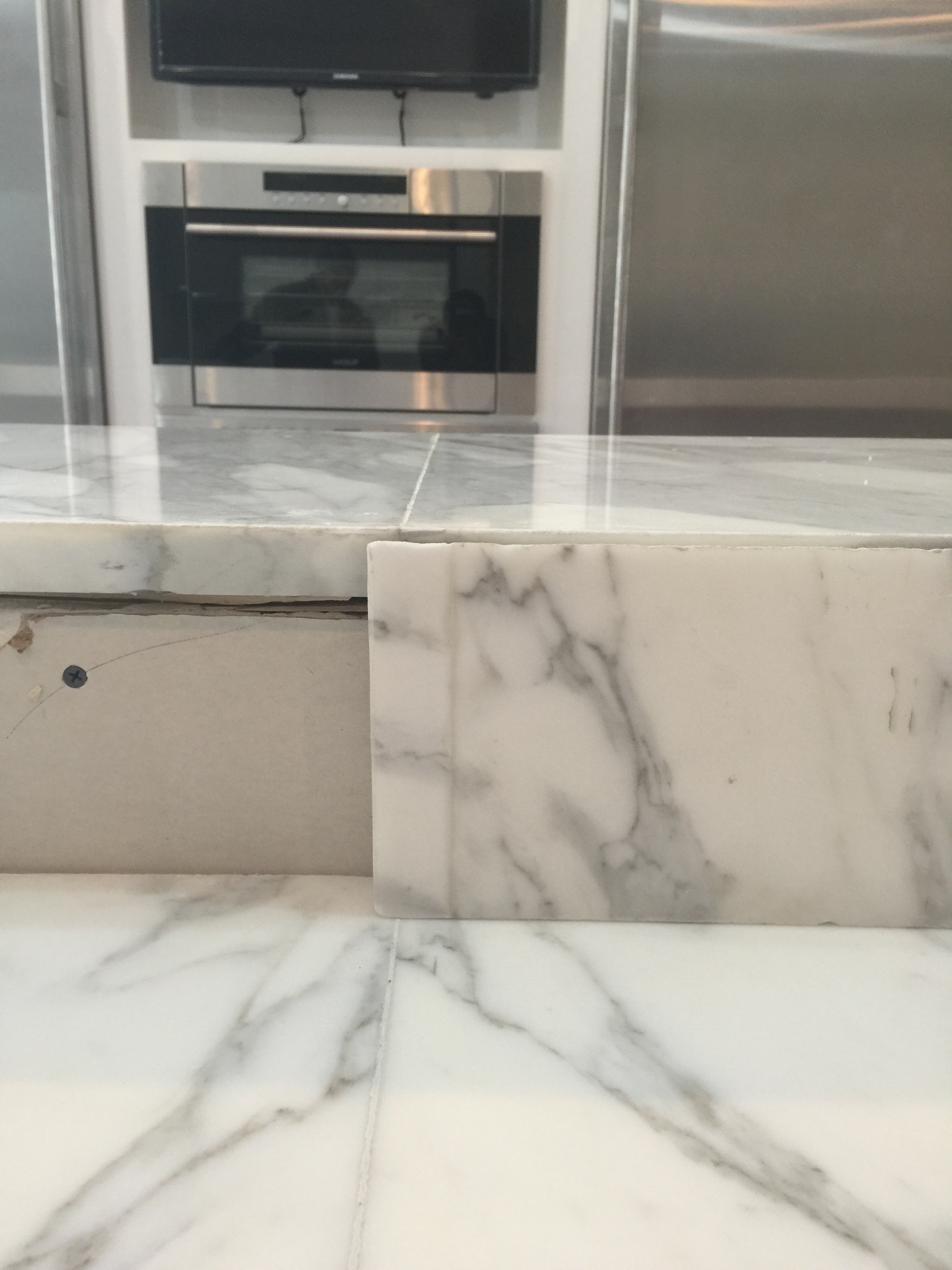

Close up showing lower level of counter-top, "short backsplash", and bar top Unaligned Book Matched Countertop Agreed upon Computer Layout of Lower Top and Backsplash (note Backsplash is on bottom, front of countertop is at the top of pic) Seam Island Front View (not showing area at issue)

While the seam doesn't line up like it should, it is "close". Not a great answer I know.
We also have the same software, I am assuming you are referring to Slabsmith software, and while it is an amazing tool it is not absolutely fool proof in its execution. You do still have to verify you set up the saw and slab correctly so everything is orientated correctly. We have been off before as well and had to remake pieces that weren't acceptable.
The fun part is finding out what you feel is acceptable. You have beautiful material. Your installation with the waterfalls going to the floor is not easy to pull off and are quite challenging to get correct. If that main seam is the only thing that is the worst part then I would consider looking at the entire project as a whole. I can't say about the backsplash seam not lining up with the counter seams until we see how the piece next to it lines up. If they are able to get a great vein match at the seam it will hopefully make the presence of the seam not as obvious.
Cameras have a wonderful way of exaggerating the seams in stone.
So in short I didn't really give you a firm answer. For some customers what you have is fine and for others they couldn't live with it.
We do have fine print on our digital layouts that say that the picture is just a representation of what you will receive and that variations can happen.
You will have to work out a solution with your fabricator.

I suggest you place a metal level over the seam. It should not rock, nor should there be a dip. Even if each edge is cut perfectly, it the pieces are out of plane, the bottom of the edge will meet before the top, creating the conspicuous seam you have.
Fabricators love this software because it creates a contractual picture of what the proposed top will look like and providing indisputable evidence that the contract was met. Fortunately for you, this picture evidence goes both ways. Your job looks nothing like the agreed-upon picture.

Was the backsplash cut short or did they slide it over to vein match for picture purpose? Backsplash can be tricky because they end up sitting 3/4" in front of the cut.
Re: Consumer w/ question about faulty install- input appreci
Rey...It looks like 3cm material, so the splash may actually be sitting about 1 1/4" on top of the lower countertop.ageless wrote:Was the backsplash cut short or did they slide it over to vein match for picture purpose? Backsplash can be tricky because they end up sitting 3/4" in front of the cut.
Siren....The vein matching will NEVER match up perfectly unless you fold the splash up and fill in the "hole".
Have you discussed this with your fabricator? What is their response?
Overall, the kitchen looks great. You just need to work with the fabricator to finish the details that are "bothering" you right now.
Did you discuss sealing and etching with your fabricator? If this is a working kitchen, you WILL have etching on this material (marble) in the future. That doesn't make it good or bad, it is just the way the material will react to acidic products. (much like a leather coat reacts to rain

What irks me even more is I don't understand how one of the backsplash piece could be 3-4cm too short (and as a result my backsplash also no longer matches). They have proposed a "fix" to the mistake by adding more material to the end with a very very small seam, but its yet another seam. This mistake just makes me think that it was poor attention to detail for the entire project on my fabricator's part.
Ultimately, I'm hoping they agree to redo the lower countertop and backsplash - but that would mean having to find two slabs that are matching and are similar enough in color to what I have (lot is already sold out). Not sure if that is a reasonable ask or possible......if its's not feasible I'd want a significant discount.

So a company can market this software and technology, show a customer what the job will look like before its cut. Then cut it different then what they showed them up front to get the job and as long as the contract was worded correctly all is ok from the business end of it? I am sorry but the industry was creating perfect book matches long before the technology came along to automatically do it. And if that's the best a digital shop can do then they don't deserve to take peoples money or money out of the market and pockets of honest/capable fabricators.
An employee dropped the ball somewhere, period. Perfect matches are achievable by laying it out with a tape measure. Heck, you can program the saw to make a few cut ins from the outside of the slab or plunge in cuts and then check them to the photo to make sure the slab is aligned perfectly.

So I spoke with the fabricator who came to my home this morning. They admit that (i) the short backsplash was their fault due to a human error, (ii) claims that when put on the cutting board one of the slabs was soft and thus the zero point had to be moved (And thus the issue with the book match), and (iii) agreed to repair the seams but that the width of the seams would not change . They admit that they should have contacted us when the zero point was moved, but claim that nothing could have been done to get a book match given the fragility of the slab.
To rectify the backsplash they extended the short backsplash as seen below. My issue is that the seam for the extension is not inconspicuous, and they are still going to need to add another vertical seam that lines up with the horizontal seam. IMO it would look horrible to have two seams so close to each other, so if I proceed I'd have to suck it up and go with one vertical seam which doesn't line up with the horizontal seams. (My other question to them was if they could get the seam so small on the extension above, why couldn't they do the same for the countertop. They said that the tops were cut by machines and the extension by hand, so the countertop seams couldn't be as small as the extension. BS? )
As for the Countertop book match, since the marble was soft and could have broken they didn't feel as if it was their fault. Again, they admit should have contacted us before the cuts, but ultimately nothing could have been done to change the layout (or so they claim). Apologies for being a skeptical consumer - but I feel like the "its natural stone which can break" is just too easy a get out of jail card.
Not surprisingly my fabricator refuse to replace the countertop and backsplash, but I'm also realistic that its probably not in the best interest of either party. So now my decision is to live with countertops that are not book matched, and with a vertical seam which isn't aligned with the horizontal seams - and negotiate a discount.

The solution of a discount will be your best resolution. I think you should consider having the fabricator bring the splice piece & splash, and not attempt themselves. Hire someone competent to change/repair the seam and do the backsplash (as conditions allow) as good as possible.
My feeling is that the existing fabricator is over his head a little bit, based on the photos and stories. The reason for the mismatch is irrelevant at this point. Negotiate a discount, get the job repaired elsewhere, and move on. Count it as a cheap lesson, far cheaper than law school.
