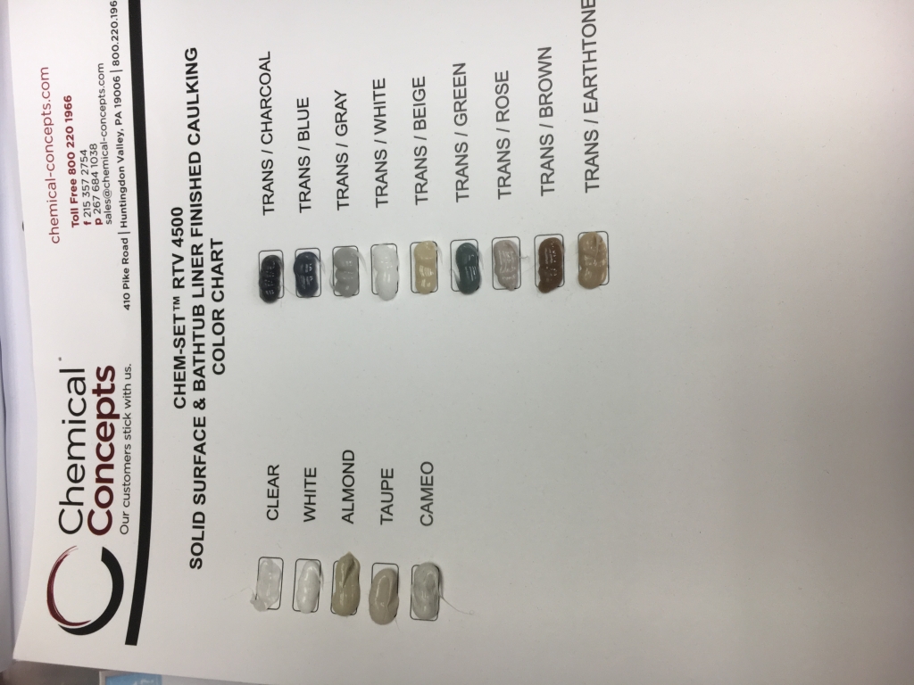

We stock a color called Trans Charcoal which is essentially a translucent black/dark gray. Very nice color. I have in in my house around my Verde Butterfly top. Blends with many dark colors. Let me know if you need any. See photo of color chart
