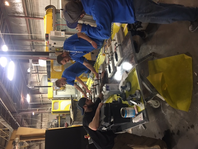

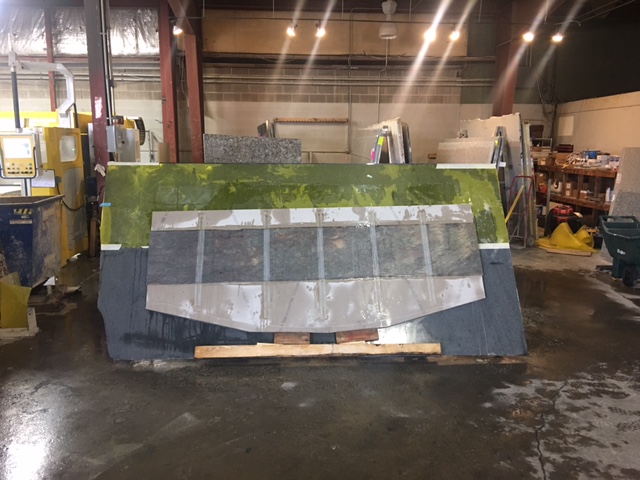

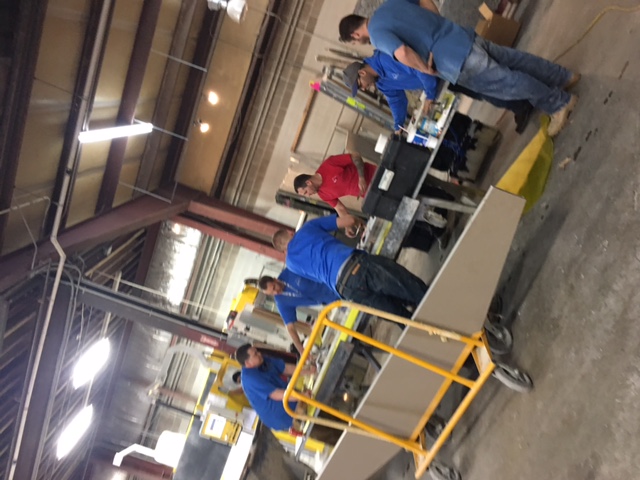

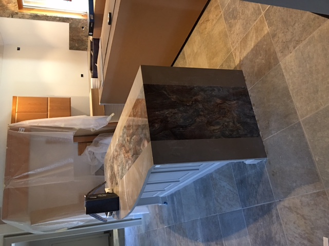

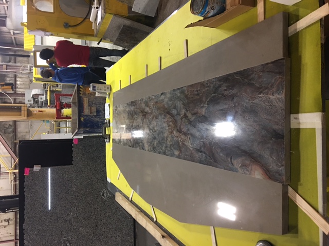

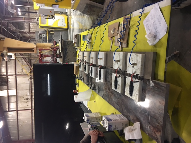

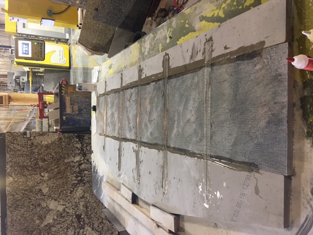

I finally figured out how do do this and wanted to share photos.
Thanks for all of your suggestions and support.
We had some delimmas as the Caesarstone was thinner than the Quartzite. We laid an old slab on a rolling fold down table and used template paper to keep the island from binding too the slab. We shimmed and leveled the pieces the best we could on the slab and then used gorilla clamps. We had to use 3 full sets or 6 clamps per side. We did each side seperate. Then we very very carefully flipped it upside down while the table was tilted to a 45 degree angle. We then put 10 steel rods inside the piece -- 2 each slot and then used flowing Epoxy to set them in. We then waited a day and ran the machine on the CNC for the radius and then cut the end off on the other side which was too big (we had to have it large so the grips would fit on.)
Then we put the island back on our CNC saw and cut the miter. We then took matching fusion and re-created the same process by making the aprons. You see a final shot in the house. I will soon have finished photos of both sides. Once again, I thank everyone who was of help in this process.
