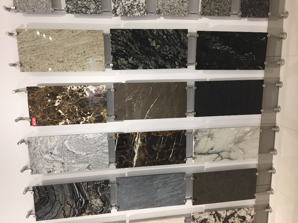

We are in the process of (slowly) building our showroom. Most of it is full stone walls as we are a small shop with limited space. However, we would like a wall with larger (maybe 12" x 24") samples that can be exchanged. Are there displays/racking such as the ones pictured, available pre-fabricated that we can install? Any suggestions?

Looks Italian/European design, very cool.

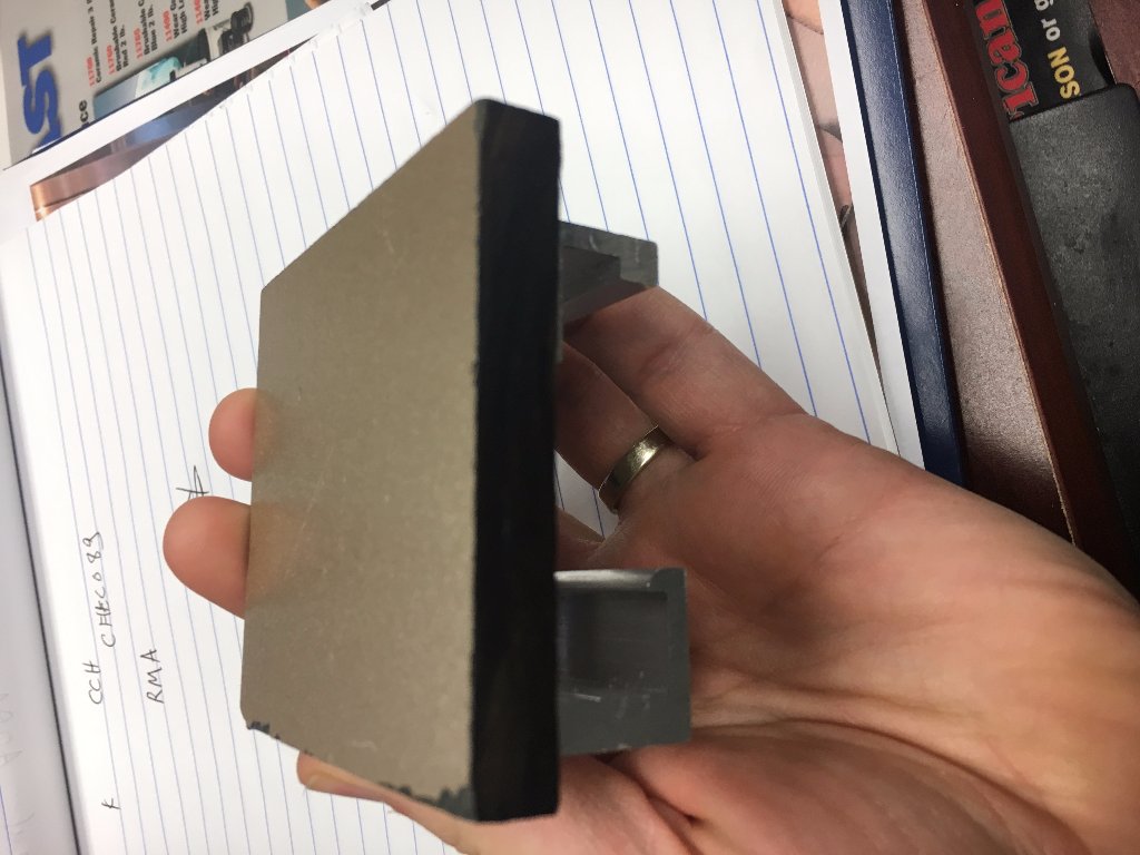

This is what Antolini has in Brazil:
It was suspended with wire. Attached on the back with plates and adhesive.

The display in the OP looks like slat wall with some metal standoffs. I believe you can get those or something similar from CR Lawrence.

Wow! I love this sleek look. Where can I get these mounts?

Monarch makes these extrusions you can mount on the wall. I have had a few customers use the Keep-nut anchors so you do not see any exposed hardware. I could not find a picture but it does look pretty slick. The "z clip" style mount makes it really easy for customers to take the samples on and off the wall.
A company called MBS standoffs makes the visible standoffs I saw earlier in the thread. They are used a lot in the sign industry.
https://mbs-standoffs.com/
