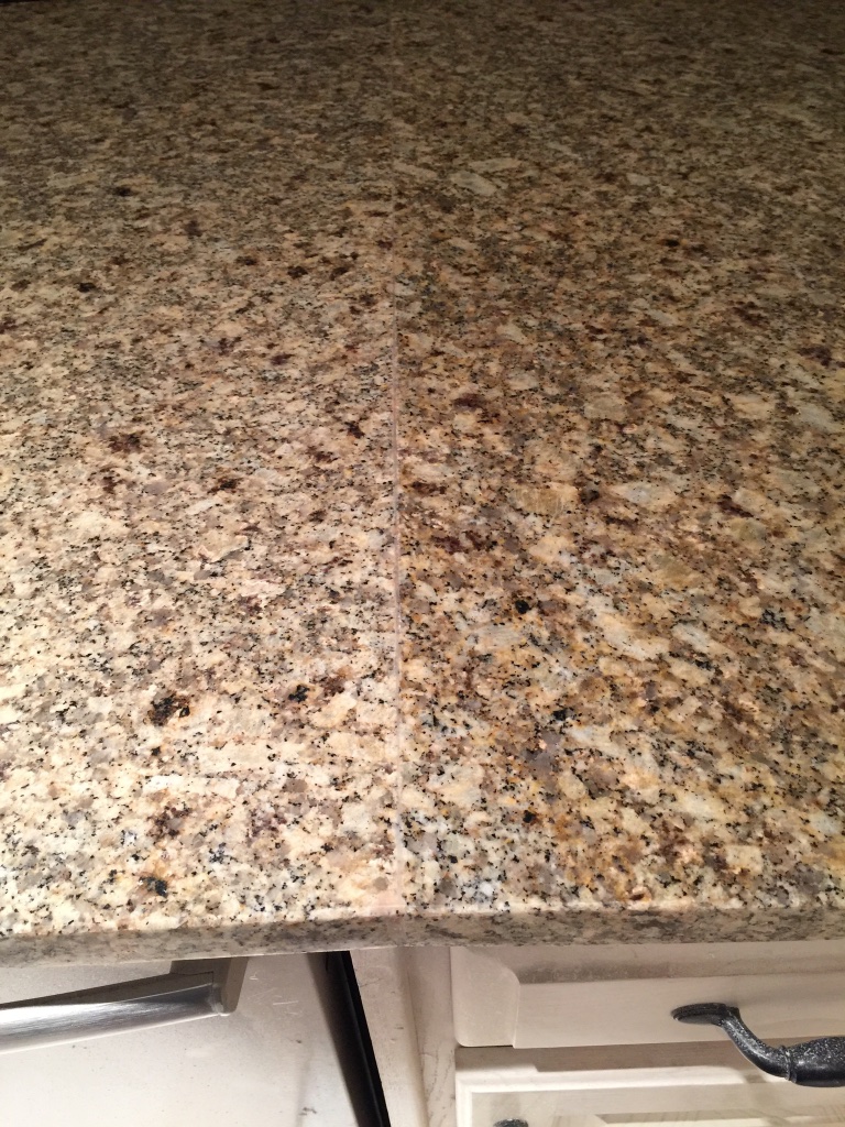

1. 1 x 2.5 block of granite glued in to reach wall

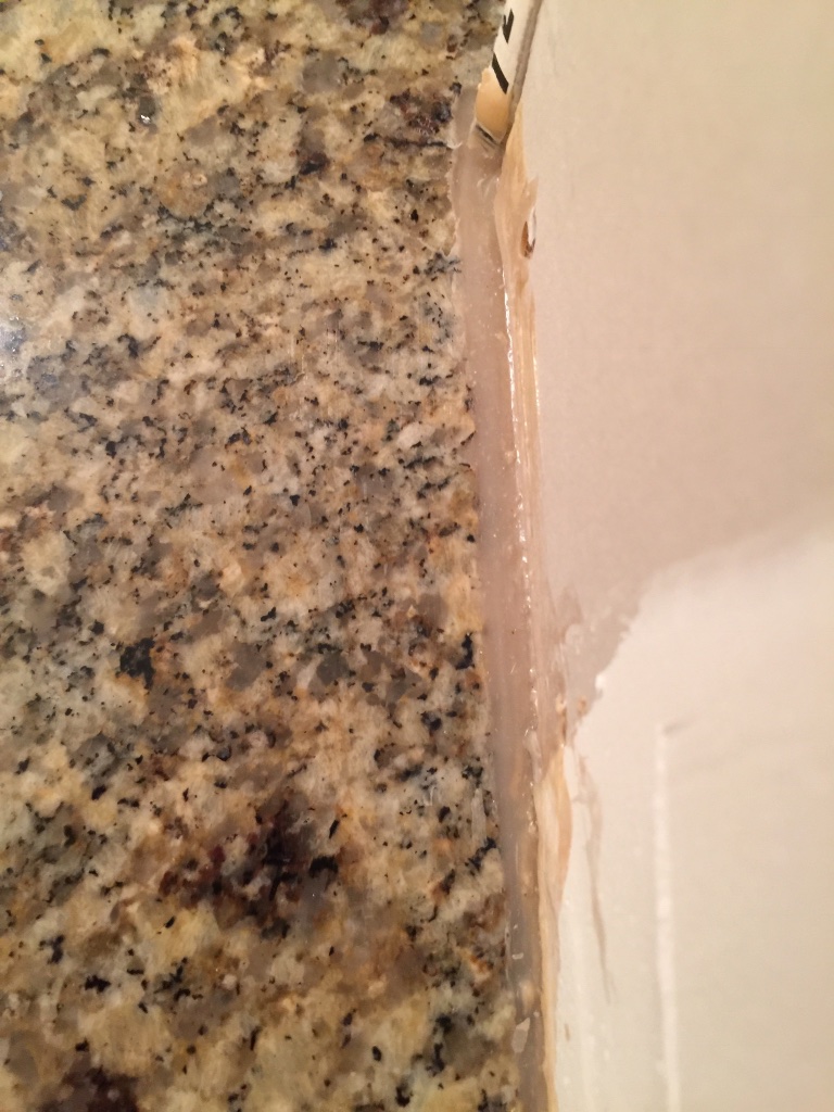

2. Epoxy more than 1/2 inch wide for granite to meet wall
3. Granite seam easily visible from across the room, slabs don't match in color or thickness

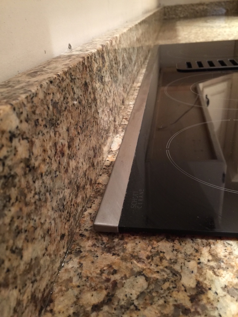

4. Stove is placed crooked by 1/2 inch, was told after he cut opening and
dropped in stove that my wall was not level was never told that before or given the chance to have repaired

1. Hard to tell there but it looks like there is some plywood patched into the wall there. Was something removed after they templated? If so and they had to improvise during install then that repair isn't the worst thing I have ever seen. A little touch up with some permanent markers and that would disappearGincourt wrote: ↑Mon Mar 13, 2017 7:42 amHi

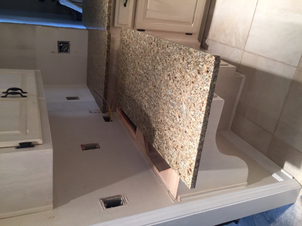

2. Did this piece have to fit in between walls? Anything going on the wall there? Sometimes the tile can be floated out to cover that. Have a photo of the entire piece?
3. That seam color match wouldn't pass at our place. The joint itself isn't that bad though
4. What does the front edge of the stove to front edge of the countertop measurement? Is it straight? If so there isn't much you can do there. We deal with this all the time and I have never had anyone want it to looked crooked in the front and back to make everything even.

The piece with the seam does fit into a large 10' pass through that was recently cut, he templated
During the cut out process.

4. The front of th stove is even but the back splash is not
It appears to me that the back splash sticks out 1/2 inch further on
One side , so to me if the backsplash was up against ththe wall
The same amount th stove would be even.

This was clearly done with 2 different lots, with regard to color and tone. The variances can be mitigated, somewhat. Probably not perfect, but better.

The glue gap can be covered by floated tile.
