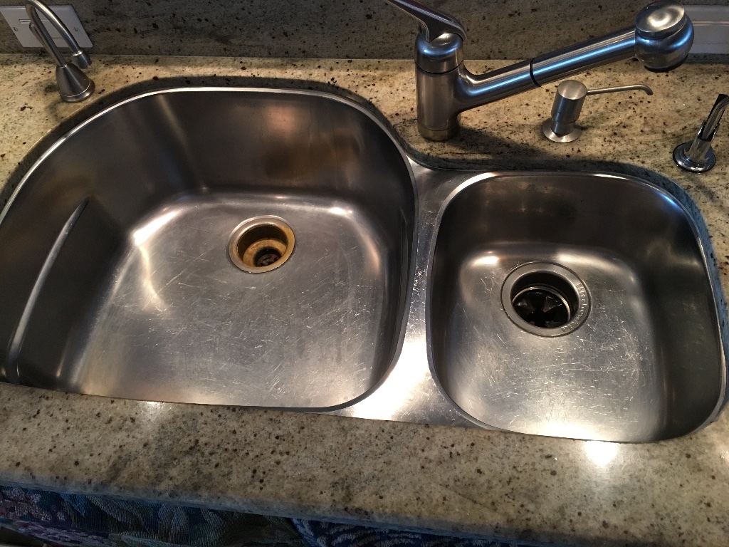

Does anyone have any suggestions for refinishing an in place undermount stainless steel sink? The sink has normal wear and tear like scuffs and scratches for a 6 year old sink none of which appear to be severally deep but I'd like to know your guys process in case they are deep. Thanks guys.

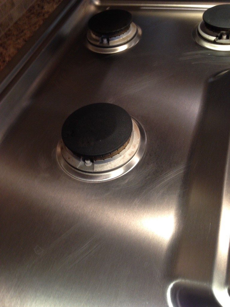

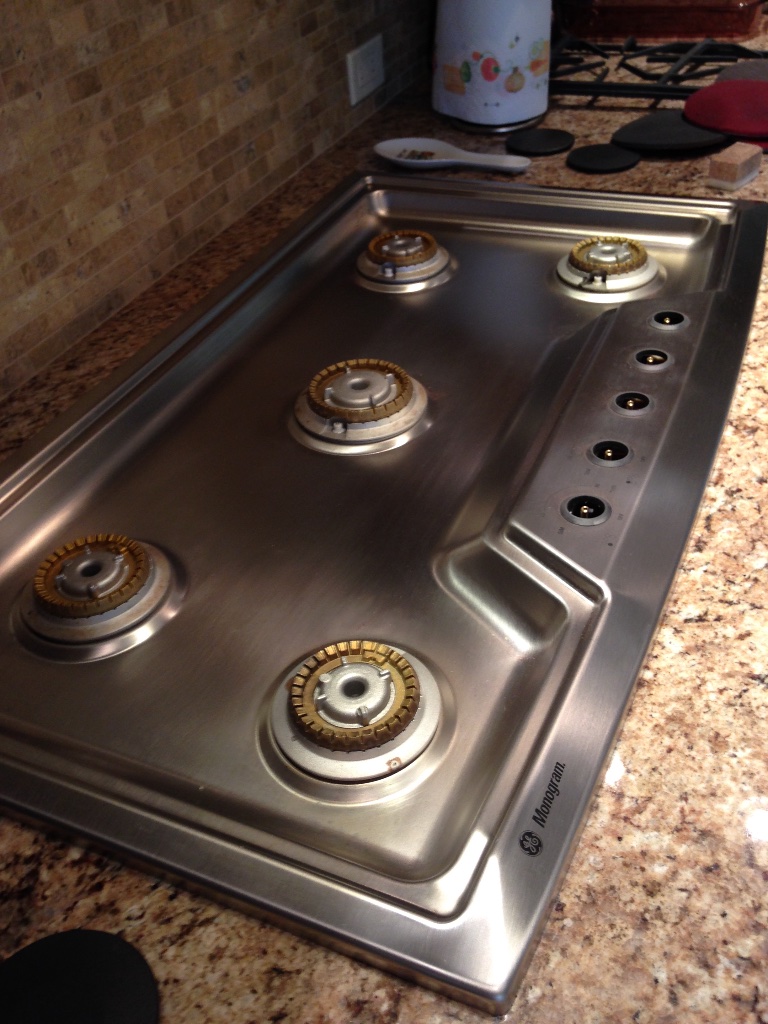

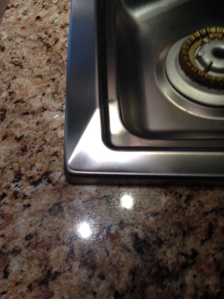

You've gotta get the deep scratches out first, direction be damned. You put the directional scratches back in by hand after the bad scratches have been removed with the random orbital. 90% of the work is in the sink bottom; the sides aren't usually too tough.
Most homeowners will forget about any directionality when they see their scratched up mess turned into consistently glowing stainless.
These were all done by hand: Not perfect maybe, but the janitorial company was happy to pay me instead of buying a new cooktop. They wouldn't have paid if the homeowner hadn't approved.
