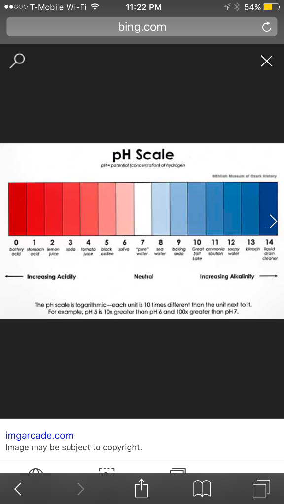

Water is not the issue with etching.
Etching is an issue when the marble (7 pH) comes in contact with and acidic solution (anything less than 7 pH) The calcium in the stone is eroded by the acidic solution. This manifests itself as a dull water spot looking mark. Although it may look like a water spot, do not be fooled. What actually happens is that the acidic solution eats into the marble ever so slightly. So slight that it can not be felt by human touch. What this ersiuon does accomplish is to slightly abide the surface, making the light refract off the effected area and not reflect off the shiny intact surface. Thus causing a difference in sheen and looking like a water spot.
Sealing will not help with etching, as etching is a chemical process that occurs in nature. Sealing is a mechanical process that eliminates or slow absorption into the stone. Two completely different issues.

Also, be aware that water is rarely at a perfectly neutral 7 pH. The normal range for pH in surface water systems is 6.5 to 8.5, and the pH range for groundwater systems is between 6 to 8.5.

Picking nits here, but Calcium Carbonate (Calcite) in marble is closer to a pH of 10, which makes it a weak base. That's why it's a common component of antacid pills.

Mark, thanks for the clarification on the pH of marble. i was always told it was pH neutral (7ph). I did not realize that it was that far up on the scale.

Based on this chart is the ph 0 will have higher etching than ph 10 am I right can I give this information to customer for their guidance.

If you believe that giving your customer a pH scale of common solutions will be helpful, then give them this information.Express Granite wrote: ↑Wed Sep 06, 2017 10:27 pmBased on this chart is the ph 0 will have higher etching than ph 10 am I right can I give this information to customer for their guidance.
I believe that the more important message is that acids (low #s) react with bases (high #s) - this chemical attack can leave an etch.
Just because the solution is closer to a 7 (neutral), it still can cause an etch.

Do you have a general terms what not to use or combine may cause the etching. To customer alot of time we told them would not get it even us. As a fabricator still had a hard time to determine what may or cause that. The more and more us fabricate marble to me just want to see if I can give the customer something to avoid as guidance . Anyone have a list want to share will be appreciate it thx

IMO, it is impossible to give a complete list. We warn against anything lower than pH 7. Marble is great , but is definitely not for everyone.
