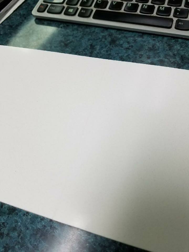

Re: Seaming white quartz
Several SFA members have found using ceramic razor blades do not have the oil on them. Never wipe with the same rag twice.
Carmine has posted in the past. That on a piece of Super White Pental Quartz and used Perfect White Integra Glue, They cleaned the pieces with mineral spirits. Put blue tape on either side of the seam, scraped it flat. Then they removed the blue tape. Once the glue was dry, they used soapy water as the lubricant and rubbed it all over the seam. Then rubbedd a white pumice stone over the seam and this is what was produced!
Here is the photo of the end result.
