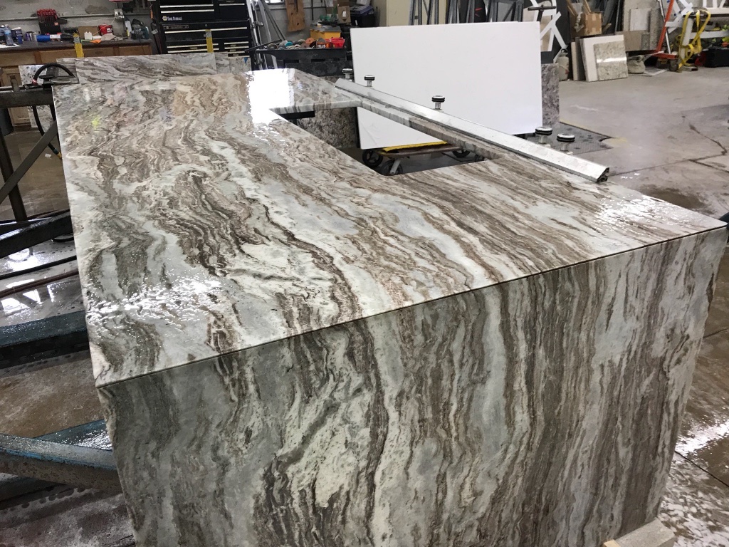

Re: Can't find a competent fabricator for the life of me
No cnc here.
- 20180508_135540.jpg (201.43KiB)Viewed 1745 times
- 20180508_135453.jpg (273.22KiB)Viewed 1745 times
Shop mock up of hand cut miter. Vein matched manually from 2 consecutive slabs.
No digital, only experience and brain power.
- No handicap with this manually laid out view match.
- IMG_1526744454877.jpg (377.01KiB)Viewed 1743 times
