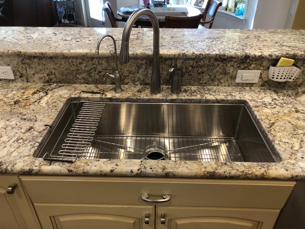

This sink is not the same as th op sink. Nice try kowboyKowboy wrote: ↑Fri Nov 27, 2020 4:00 pmzyyz802:
Your fabricator blew your sink position; there's absolutely nothing wrong with your sink or faucet choice. That ugly fat poorly functioning front sink rail could be as thin as 2 3/8" (see below), not the 4-5" pictured. Had he done so, the faucet would have plenty of room. Once the sink is strapped, not clipped, in place it provides plenty of structural strength to the counterop. The sink supports the top with straps, it doesn't with clips.
Completely fabricator error.
You can dance a Conga line across this skinny rail:

True enough, but irrelevant. The OP's sink is apparently a Krause Kore. The dimensions are 32" x 19". Plenty of room to pull the sink forward: https://www.kraususa.com/kitchen/kitche ... ories.html
The sink I pictured is a Kohler Strive, 35" x 18 5/16", just 11/16" smaller than the Kore:https://www.us.kohler.com/webassets/kpn ... ler_en.pdf
Thanks so much for making my point that this is purely fabricator error. Take another shot please.

So are you suggesting that the fabricator pull the sink so far forward as to make the false front tilt outward so as to catch all water that hits the front rail as it is in the photo where you retrofitted a bigger sink in an existing hole? Pretty sure my customers wouldn’t accept that. Just saying.....Kowboy wrote: ↑Sun Nov 29, 2020 9:04 amTim:

I am suggesting no such thing. I did not retrofit a bigger sink into an existing cutout. There is no bulging false drawer front. Pictures and math are kicking your a$$ today brother, but hey, go ahead and take another shot please.

Kowboy
You do nice work on saving rod jacked counters
I’m truly amazed at how you fix those messes
That being said
I don’t agree with you on this particular thread
There is a solution beyond recutting the cutout and bashing what all fabricators do as standard
I set all my sink cutouts at 3.875 “ period
I’m not dealing with a broken sink rail and a lot of materials people pick nowadays is certainly subject to failure with a smaller sink rail
Get a different faucet or turn the darn thing a bit and move on

When you replace sinks for a living and see the same fabricator mistakes over and over again you quickly justify "bashing what all fabricators do as standard". I don't care if it's in the Natural Stone Institute's fabrication manual. Just because a lot of guys do it doesn't make it right. The "...but we've always done it this way..." mentality remains strong. If you're creating fat ugly dysfunctional faucet-crowding front sink rails and installing sinks with leaking clips, I'm going to call you on it unapologetically.
I don’t do anything like that
I inform customers on oversized sinks
Cabinets that aren’t 24”
Some older cabinets are only 23-23.5 inches deep
Window sills that stick out to far etc etc
But I hold true to my setback
