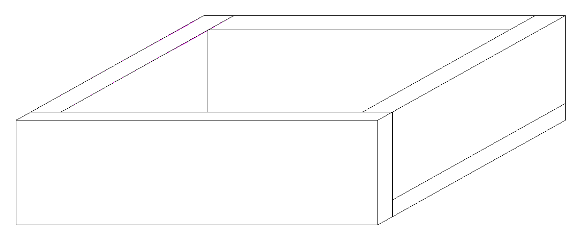

On the few sinks that we've done (ES, granite, and soapstone), we use butt-joints. I cut the bottom as a full solid piece, with the sides and back sitting on top of the bottom. I design the front face full height so it is in front of the bottom piece, hiding that seam. The only visible seams after it's installed are on the front left and right sides. Here's a simple schematic: To slope the bottom, first cut the hole for the drain. Then cut a recess for the drain flange and leave 1/2" of material thickness where the flange mounts. I then put some layout lines on the stone from the corners to the drain center and start grinding with an aggressive cup wheel and a lot of water. You can tape of the edges where your dado/miter/butt-joints are going to be. Start by grinding the most material along those diagonal lines, then blend the whole thing together. Use a straight edge across the piece to check the slope in different directions. Once you get close to the shape you want, use your regular pads and bring it up to a hone to match the tops.
Use a good full epoxy to assemble the pieces. We prefer Touchstone Edge 2-part epoxy. Tape off all surfaces next to the edges being glued up - makes for way easier cleanup. Clamp them and allow to cure overnight, then you can use you pads again to go over the exposed areas of the sink to remove excess glue and smudges.
