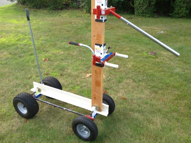

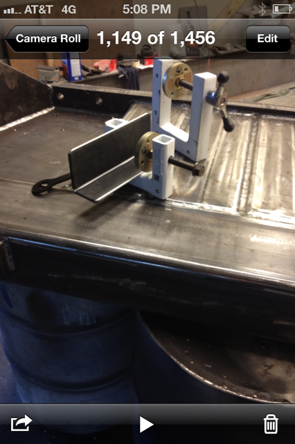

No feedback needed.... just showing a few of the fellows who were interested that I haven't forgot them. New extension handles for sink cut out handling... New Granite style handles, Wide tires to prevent tipping and improve stability over flagstone sidewalks. NEW BIG O clamp.... its steel and allot stronger then my present clamp which can be seen lifting over 1200lbs in a demo on youtube. Yes you can tilt slab directly out of cart. Yes you can use Fulcrum attachment when going up stairs.... There are also steerable axles if you prefer those for turning...
That's all for now....

What comes to mind is when us kids used to take apart baby carriers and make soapbox cars out of them, nothing compares to going down the town's only hill trying to stop with your feet before the crash lol

You guys have to give the guy some credit. He is trying to build something that will make our jobs easier and yet make some coin for himself without copying another companys product. Hats off to you John. keep reinventing the wheel and it will happen.

(The following is my unasked for personal opinion, I am offering it with the intention of helping, not putting you or your product down in anyway)
I'm sorry, but I charge my customers a good amount of money based on the premise that we are a serious, professional, company. These carts and clamps look very amateur. I wouldn't feel comfortable showing up on a job site in their current condition. I'm not talking about the concept, but the execution. I would suggest that you should have someone with product design skills help you to make this look like an intentionally designed tool. Right now it is mixed and matched and somewhat anemic looking. I think if someone with that background could really make this go a lot farther.
Not everybody has product design skills, I don't, if I made something similar, I would need to get that kind of help.

Before their is any confusion, the products on the video are Omni Cubed carts. They make top quality products for our industry.
Re: OTLVISE Granite Line
Using a cart that is steerable certainly would have saved allot of back strain as shown in video...

There are more efficient ways t use those dollies, than depicted in the video.
Steering would probably be a weak point in the design, due to weight and safety (balance) considerations.
it doesn't make sense to me to place a winch\strap\etc on the front clamp...
Steerable low profile Dolly seems like a good idea

First I would say that's the dumbest way I have ever seen to get a island out of the shop. As a shop owner I would have been up set about that. I would have put it on a aframe and loaded it. Secondly two omnis are great for transitioning angles like ramps,but maneuvering is far easier with just one in the center of the island. We call it wheeling the top. It takes way less effort to "steer" the island this way. The only time we use two omnis is if we have to transport sink down. The lift Omni makes is cool over priced but cool. No offense Larry. But that island is no way near full slab and we would have installed it with three guys. Either just lean it against the cabinet and tilted it over/went on the end and pivoted it around or just picked it up and leaned it over. I way 150lbs and none of our guys are body builders. Its about working smart not hard.

I agree...3 guys easy. 2 with experience would work just as well.

Why does it have to have 36 levers and handles sticking out everywhere?
they are there for display.... the use of various handles etc with the same clamp is the idea and they work in rain, snow or whatever
as shown it makes odd size pieces more manageable

was merely demonstrating the single pole handle as I was asked why were there so many levers etc..... those were prototypes and performed no problem... have seen many pictures of your trade carrying odd pieces when they could use this style handle instead and walk forward for example going up stairs.
The new BIG O clamp shown on top has plenty of clearance at 4.5 wide, 3 inches to bottom of clamp head
Dan, I just like making stuff lol
