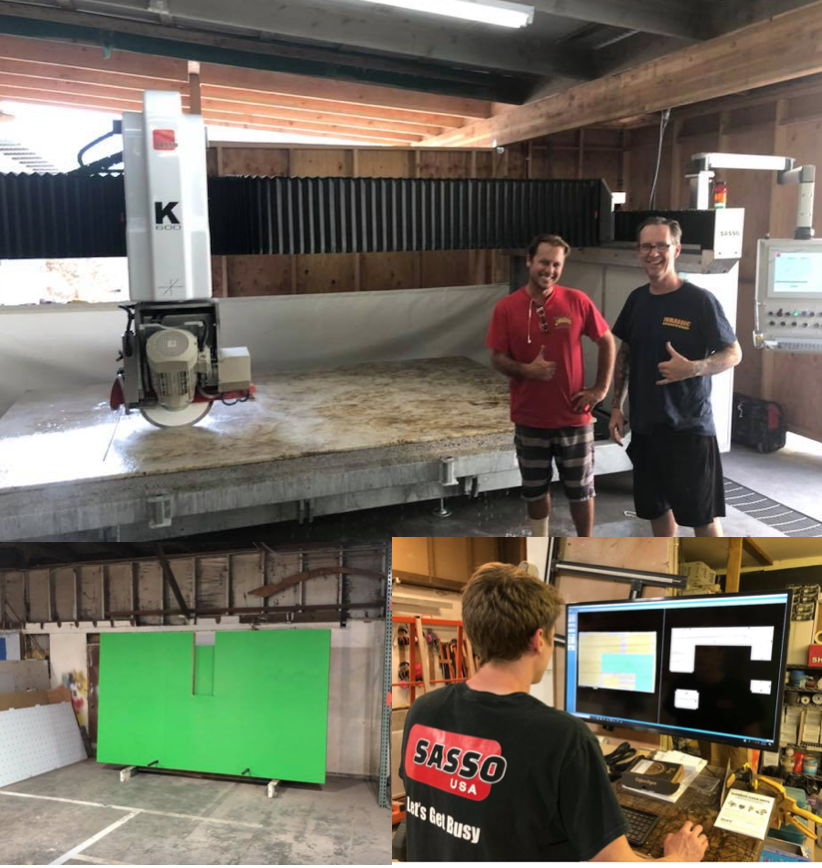

Last week I set up slabsmith, a K600 and alphacam with a shop on Maui....they could not be happier. Gimme a ring sometime and I will give you that customers number as well. This does not have to be hard.
