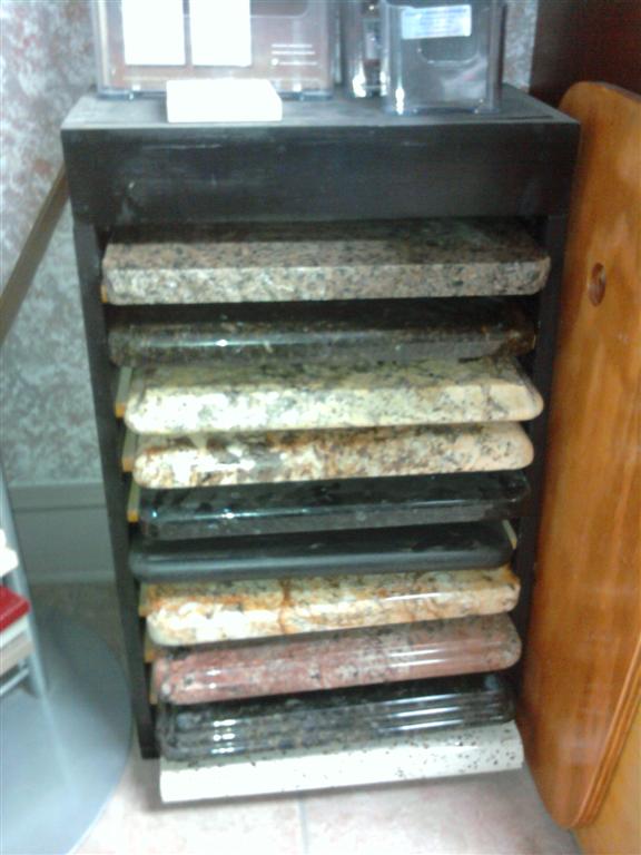

We have dealers that had that octagon sample piece with all the edges and they HATED it! The custy always felt they couldn't get a real feel for what it would look like
So we made 16" x 20" rectangular samples of each edge. Routered all the way around it with a radius on the outside corners. Then we cut that rectangle in half so it made 2 samples out of one piece (16 x 10). We then made a wooden display unit that allowed for each edge sample to slide in. This works if you don't have a lot of room for separate cabinet displays. Custy's love this! Our dealers love it, too!
Here's a bad cell phone pic of what we did
Don't bother.

Carmine,
That is exactly what e do, only we use 25" x 20". everyone loves them.

Re: 2nd dumb question
Yeah that would work. But I think il just do as Dan and Carmine have said. Way easier. And I am owed a favor from a cabinet guy
