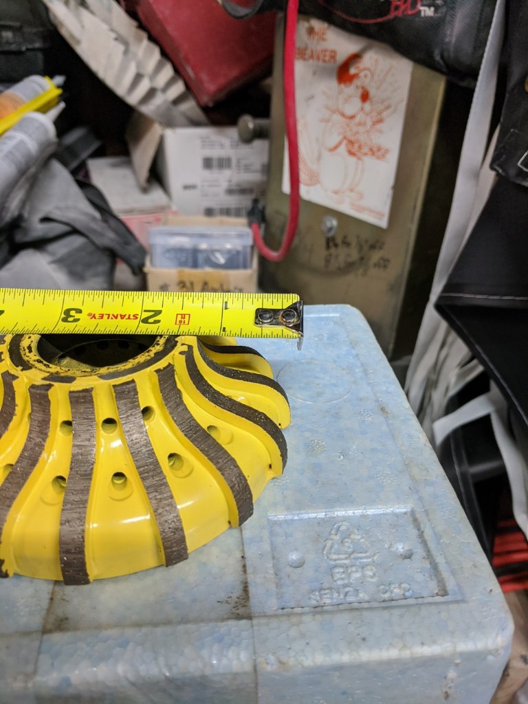

I believe these are what you are looking for they have been sitting around for a while and I am missing pos.2
I have pos 1,3,4,5 and two polishers.
Send me a PM if interested.

Those are old Nicolai wheels. You are not missing p2. G3 is p2. G4 is p3. G5 is p4 etc...

Thanks for the info.
