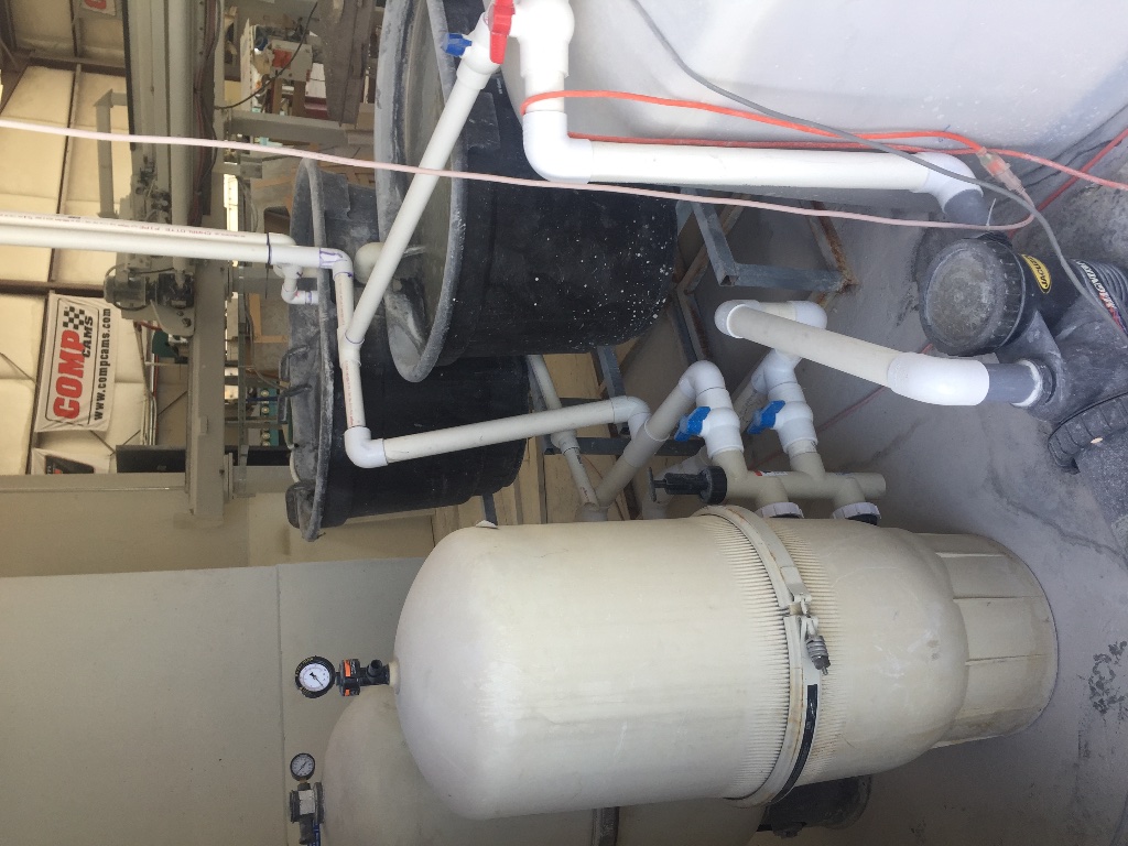

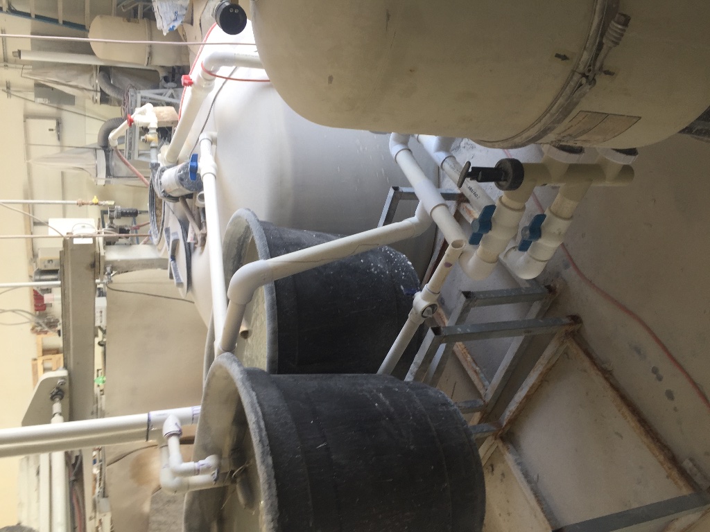

Honestly I don't know how much gpm I have another pump that pushes the saw yukon witch is a 1hp witch produce I think around 85 gpm but I have a blow off that reduces that gpm so when saw is off the pump keeps running and doesn't over heat the pump The saw is a yukon I don't run this pump thru the pool filters because it's only cooling the blade
Then I am running a pool pump 1 1/2 that is running thru two pool filters at a pressure of 32 pounds of pressure on filters I am running 1 1/2 inch water line about 100 ft to a multihead Luna 740 machine which I have to be running around 75 gpm roughly and on that I do have a water blow off so that pump doesn't over heat. I don't have my wizard hooked up yet too it but I will then I have slump pumps in shop so it can recycle thru then goes throu to the drop down tanks and back thru once in awhile I need to add fresh water to my holding tanks The filters I clean once a month I am probably getting 20 microns maybe lower since it's going thru two pool filters
I purchase the pool pump and filters used but my water system cost me with tanks and everything around $2000
In the end of the day I clean out my water lines with fresh water
