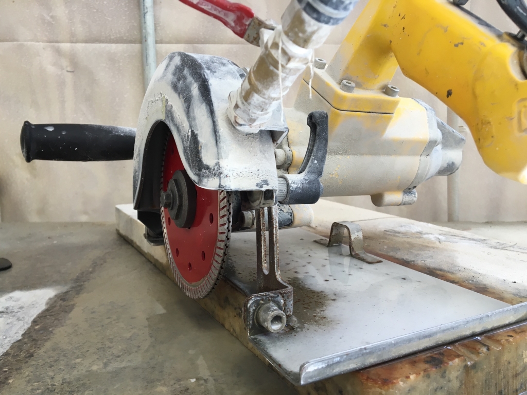

This! We've tried many different ways and this is by far the cheaper, fastest and easiest way to rod. We have used both the new Alpha PSC-150 pneumatic skill-saw, which does use an absolutely ludicrous amount of air, as well as the Alpha AWS-125 Electric 5" skill-saw. Both yield amazing results when running two inexpensive 5" blades stacked. We can have a piece with two sink cut-outs rodded in well under 5 minutes.BReynolds wrote:alpha air saw with two blades stacked together, we only cut about a 1/4" wide channel. Takes maybe 3 min to cut both slots and that is with measuring out and drawing a line on the top to follow. You will need ALOT of air to run this saw though and a 3/8" dedicated airline run to it.
Our experienced guys just mark out the length of their cuts but we have made some guides from 2cm quartz for the newbies to clamp to the piece.
- STACKED-BLADES.JPG (500.18KiB)Viewed 346 times
