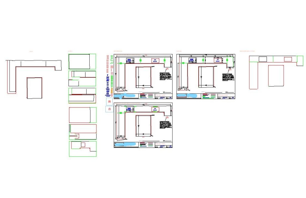

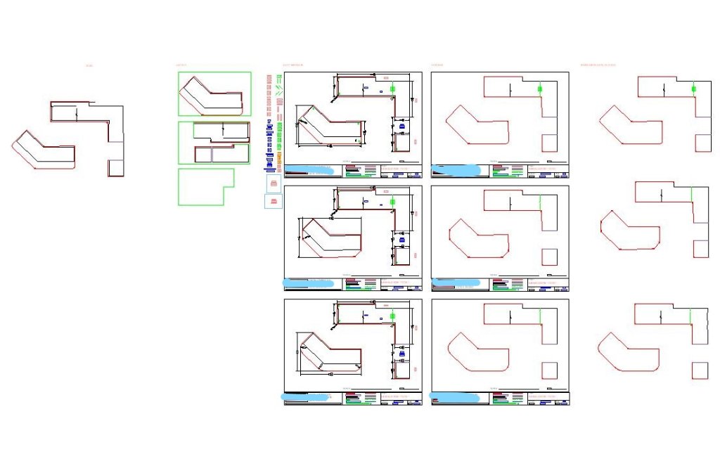

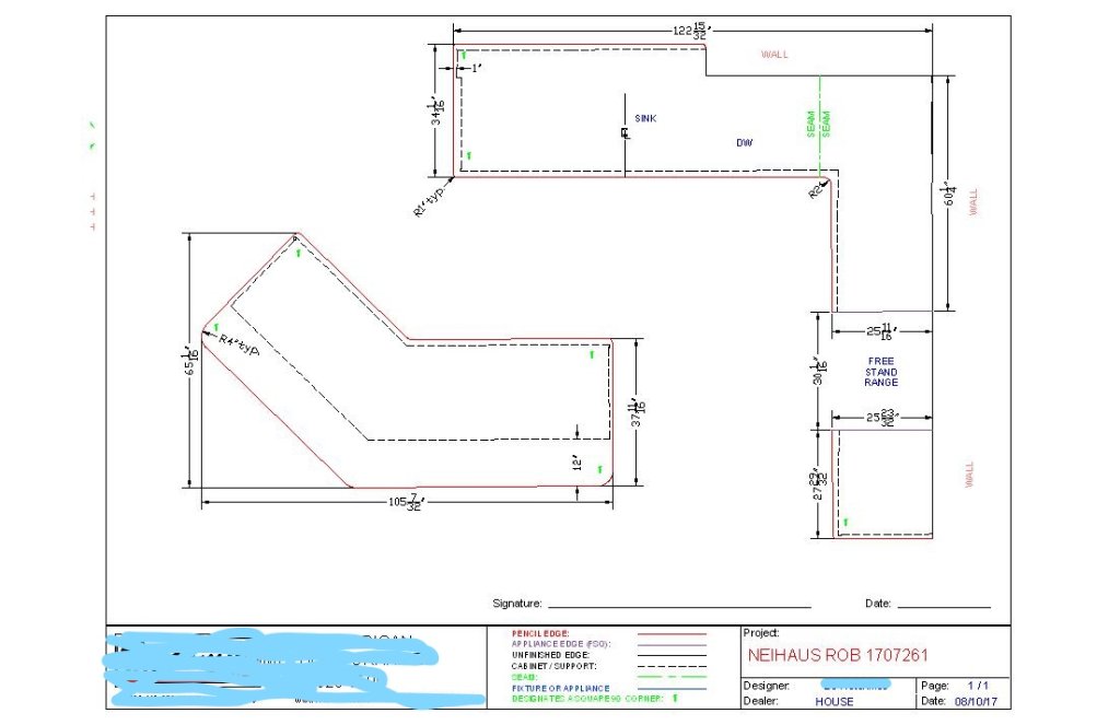

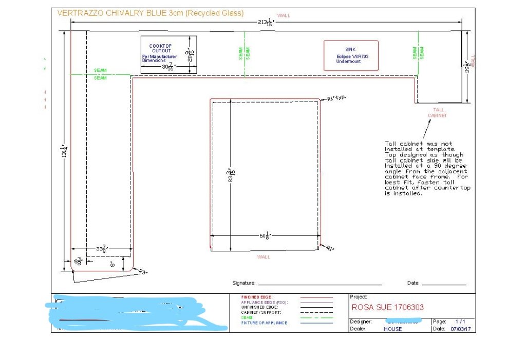

I've attached what is the environment for the 3rd job on the spreadsheet. And a closeup of the actual drawing that the customer went with. I gave her 2 seam design options.

Here's a job that I don't think I put on the spreadsheet because it's not done. The customer has given a down payment but wants the job done a little at a time. It's a bit more intricate than a typical job, which I love doing.
- InkedNot On Spreadsheet_LI.jpg (60.41KiB)Viewed 1130 times
- InkedNot On Spreadsheet Closeup_LI.jpg (95.45KiB)Viewed 1130 times

This is the first job that's listed on the spreadsheet
- Inked1st Job on Spreadsheet_LI.jpg (79.84KiB)Viewed 1130 times
- Inked1st Job on Spreadsheet Closeup1_LI.jpg (70.67KiB)Viewed 1130 times

I added in the locations (in dark red) in which I had the laser. I had to re-position once in order to shoot all sides.
- InkedInked1st Job on Spreadsheet Closeup1_LI.jpg (71.42KiB)Viewed 1130 times

I take physical measurement. I do not try to figure it to the 32 of an inch when I do they are quick measurements for reference.
As far as seam options to the customer. If they ask I tell them where I would put them and why. I also tell them I wont be sure until I lay it out on the actual slabs, so emailing them different seam options is 1 thing that is taking more time than it should.
Even being less than a year into the leica I would be upset if any of those templates took and hour to do.
If I have to relocate the laserI just save whatever I have shot,shut it down move it where it needs to be and start shooting under a different file.
I also see that you templated one that was missing a tall cabinet, I would not do that but thats just me. If everything isnt installed they are not ready for a template. if the cabinet maker ended up putting in a filler between the cabinets that would have screwed you. which I find ironic that you do not trust the laser to do its job but you trust the cabinet guy
I dont think that anyone is going to have the answers that you are looking for. I believe you are set in the way you do it.
the u shape with the raised bar. How many times did you move the laser to get that?

I didn't move the laser to do the raised bar. It's non-crucial dimensions because it has overhangs all the way around. So there's nothing that "pins" me.Justzack wrote: ↑Sat Aug 12, 2017 2:46 pmI take physical measurement. I do not try to figure it to the 32 of an inch when I do they are quick measurements for reference.
As for the tall cabinet issue, that was discussed w/the customer. They understood the ramifications prior to me ever coming to template, so it was their choice. That's why I put it on the drawing that they approved. Legally speaking, it was done by customer orders.
I do discuss seam options at the template. This customer was being picky about it & was attempting to tell me how to layout the job on the slab. I didn't bother with arguing w/them & chose to instead present them options so they would feel good about it, as it was apparent to me that they were the type of person that wants to feel like they were in total control. That's certainly not anywhere near the majority of customers by any stretch.
When you say you've relocated the laser & shoot under a different file, I assume you mean completely different sections of countertop & not that you had to move to shoot other sides of the same sections, correct? For example, that kitchen where I pointed out where I put the laser. I could've just shot the whole job from between the island & the sink section, but then I wouldn't have gotten the back of the wall behind the sink, nor would I have gotten the back of the island. I would be comfortable with not having gotten the back of the island, as I didn't double check those dimensions anyway, but the back of that wall was a little important as it wasn't parallel with the front of the sink base. Also, it was currently a raised bar that they wanted to tear down & make one level with the rest of the countertop, so shooting the wall & seeing how much of an overhang to make based on how out of whack it was ended up being something that, to me, seemed valuable to know. As, if the overhang ended up being 1" on one end & 1/2" on the other, there may be a judgement call that the customer might want to make there: Make it parellel or not. The customer chose parellel.
I could've put targets on the top of the upper bar, but that wouldn't tell the story of where the wall would be once they cut it down to level w/the cabinets.
