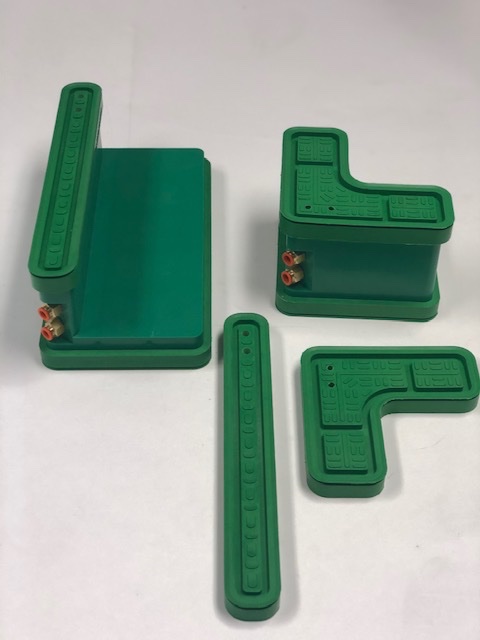

For those having issues with water there are two things you can do to alleviate that.
One is stand the pods on end and it will drain the water out. And the second is when you lift a piece off the table don’t stand it on end and let all the water drain directly to the pods.
Hope this helps!!
We also have new sizes coming for those that use Green!!
40x300
And and “L” Shape!
Hope this helps!!
40x300
And and “L” Shape!
