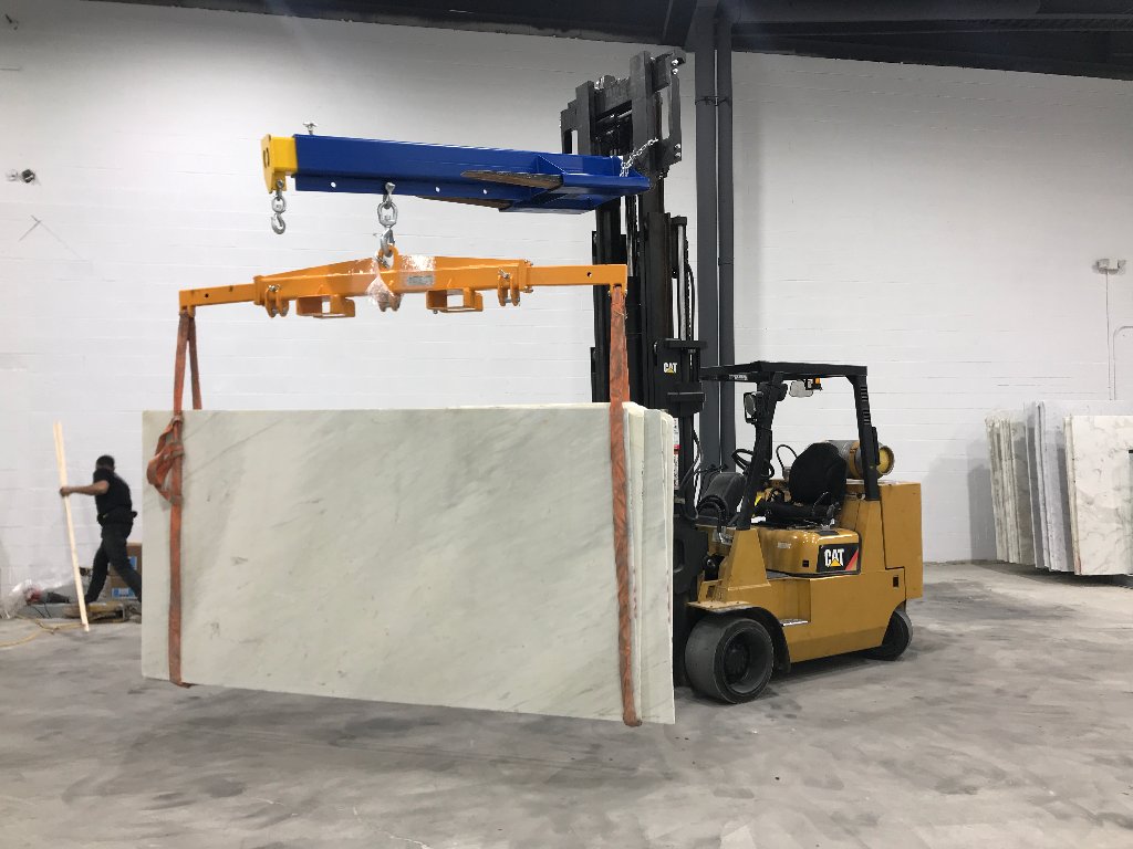

Re: Best way to unload to unload bundles
This is a 12,000lb forklift. We had a hard time with an 8 slab bundle of slabs that measured 126x80. But we've been using the 12,000lb to unload containers the past couple weeks. With the exception of that one bundle it's moved everything.
Alex
I just bought the exact same set up from Braxton Bragg,Thought I had it figured out ,turns out my forklift is about 12-15 inches short of being able to unload off of delivery trucks .Now I have to buy a different boom or different forklift.
