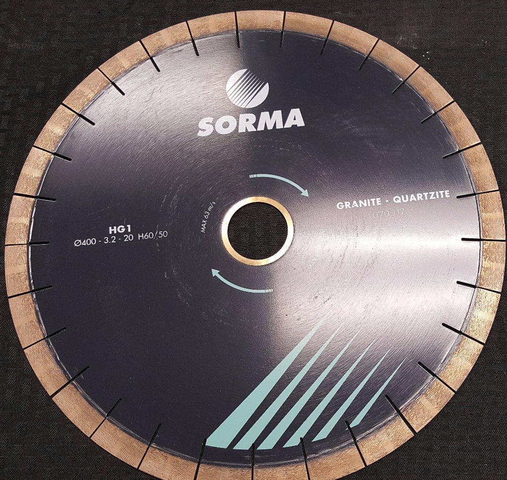

We have seen the White Lion perform well in our market. We have spent 11 months looking in Europe, Brazil and Korea for a very good blade for Quartzite. We have been Importing directly the SORMA Quartzite blade from Italy now for 4 months.
We got good reports from customers running a GMM with the Sorma and then we sent it to a friend of ours who has a robo-saw. H
e really liked it and re-ordered the Sorma.
We believe these 2 blades are the next generation of the "original " designs from the engineers in Italy. If you think back their response to Quartzite was to put 2 segments on one landing and also a semi-soft bond. The White Lion has a U shape segment. If you look closely at the Sorma Quartzite, they have a pattern diamond design at the 2 ends of the segment and no diamonds in the middle of the segment. Therefore creating the 2 segment design while allowing for 1 segment ,( in length), attached safely to the core.
Mr Lauzon's point is well taken we still believe strongly in Silent and then Non-Silent for Mitering. That is why we bring in both designs in from Sorma and the DIATEX Neolith, Dekton and Lapitec blades we are bringing in both designs. The recent post from Vadim on his Sasso was a silent Diatex.
Mr Lauzon we have 1 - 16 inch Non - Silent we would like to send you to test. Would that be OK with you? If so let us know how to arrange that.

- Sorma Segment
- Quartzite segment - Sep 2017.jpg (111.29KiB)Viewed 2842 times
- Sorma Quartzite Blade
- Quartzite Blade - Sep 2017.jpg (330.74KiB)Viewed 2842 times
