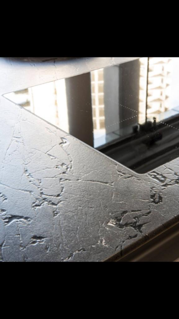

2mm gap all around. Always talk people out of it. If they are adamant we show them this picture and get them to sign an acknowledgment that there will be a 2mm gap on all sides.
