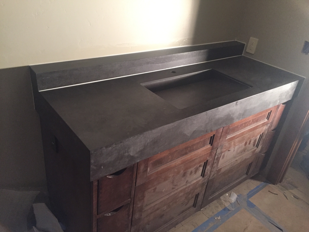

so here is what i came up with.
- IMG_5732.JPG (455.02KiB)Viewed 487 times

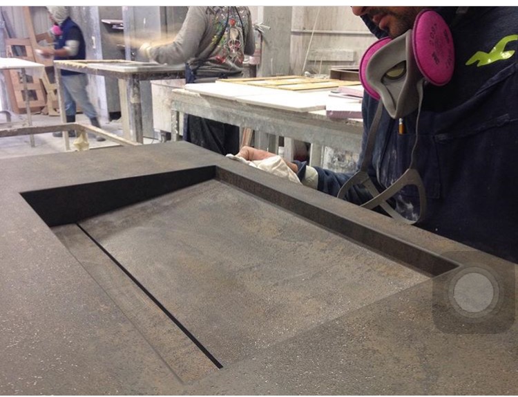

Re: Mitered Vanity sink with 12mm neolith
in the shop
- IMG_5703.JPG (529.54KiB)Viewed 487 times

kkhrestsov wrote:so here is what i came up with.
Great Job!!
Looks really nice! I take it the customer was happy!!
looks great!
