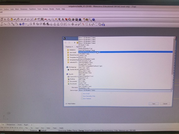

I am having troubles with my CNC software scaling my DXF file once I upload it. It looks fine when I view it in a CAD program but once it is uploaded it comes up extremely small.
I have tried to scale it in my CAD program but once I try to save it, I can not save it as a DXF. How do I do so?

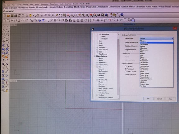

First make sure if you are drawing in inches
in the toolbar >options>document properties>units
if is in inches you can change it to millimeters it will scale it by 25.4

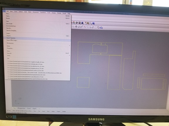

now zoom out to see your drawing select everything that you need and go to
File>export selected and choose .dxf file name it and save. done
