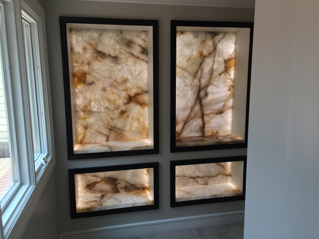

We recently installed a similar translucent & mostly transparent quartzite called "Skyfall" in a pirate ship bar over light pads (wish I had completed photos to share) and had loads of trouble. Stone crumbled when picking it up off the saw, broke when adding the Ogee edge on the CNC so we had to hand router it all... Fab was a nightmare but after a lot of time and TLC it looked phenomenal. Have loads of epoxy around... Just my $0.02.

skyfall
