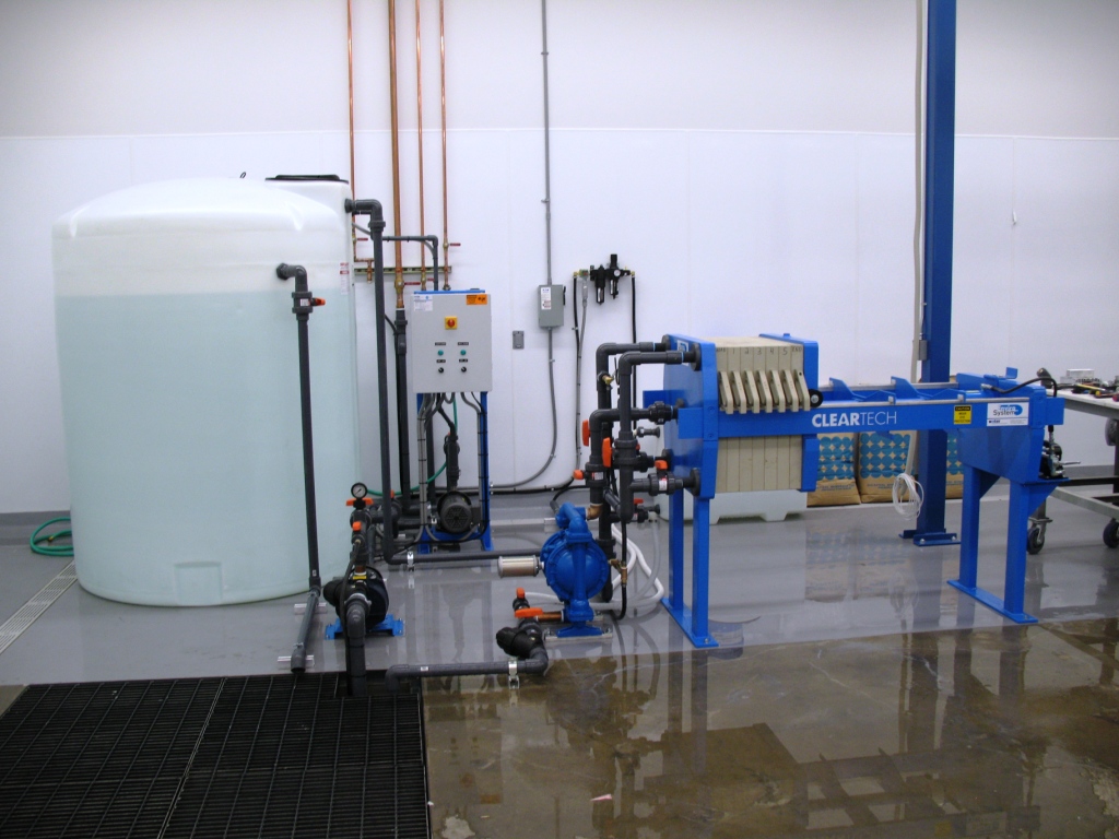

Re: Water Filtration in Shop
Scooter, here are a few Systems we have installed. And as I mentioned above, we tailor each of our systems for the particular operation - primarily based on water demands and fabrication volume. So, two photos were designed for smaller operations producing a few kitchens a week, and the other two were designed for much larger operations.
Feel free to call us at (603)758-1900 or you can shoot me an email at Jbolduc@watertreatmentonline.com
- SemiAuto Model 25
- SemiAuto Model 25..jpg (329.18KiB)Viewed 486 times
- SemiAuto - Model 6-10
- SemiAuto - Model 6-10..jpg (178.95KiB)Viewed 486 times
- Model 2-6
- Model 2-6.jpg (284.08KiB)Viewed 486 times
- Model 1-2
- Model 1-2.jpg (335KiB)Viewed 486 times
