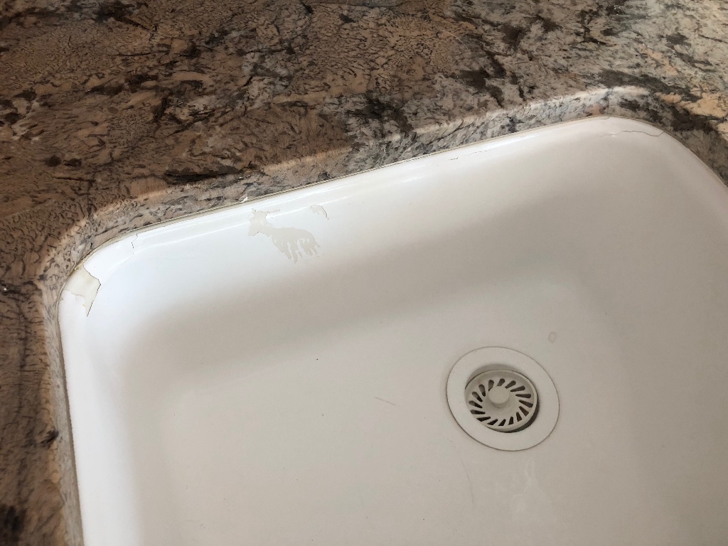

Crumbled granite at inner sink edge with rusted rod

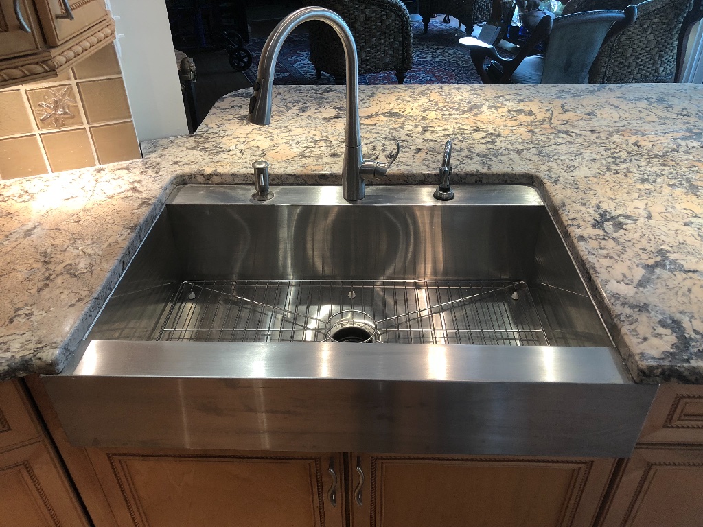

Hello all-
I have a rusted rod that caused a small amount of granite to crumble into sink as the rod is visible at the inner edge of the sink. I live in the Philadelphia suburbs and have not found help with rod removal and repair. I would prefer to remove the rod from below and expoxy the damaged area rather than putting in a farmhouse sink. Does anyone know of a person in my area who can help? I saved the pieces that fell out.
My zip code is 19382.

How would you repair this? Would the repair last? Someone in my area said it was difficult because the rod is at the edge.
Re: Crumbled granite at inner sink edge with rusted rod
I would drop the sink, remove the cabinet front, and remove the rod. The rod absolutely, positively, must go; there is no permanent repair with the rod in place. With the rod removed, I'd pop a backsplash to get some matching repair material. If none were available, I'd move the sink forward. I'd recut, re-profile, and re-polish the sink cut out to make a larger positive sink reveal; the flange on the composite sink should be wide enough to allow this. There is no need for room for clips on the front rail, because I'd strap the sink back in place; the superior method. This repair would be permanent and inconspicuous. Were you local to me, you'd have to budget about $1,500.00 for this repair. The sink would be back in full use in one day.

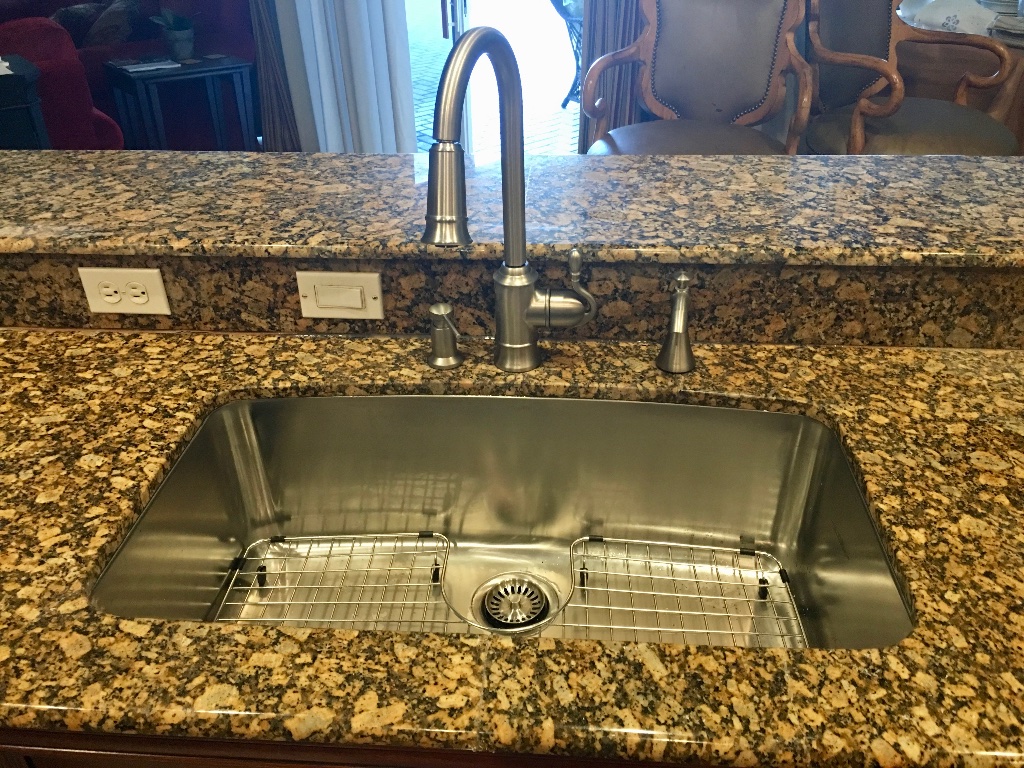

I'd have a 33" x 22" Elkay ELG13322 in the truck just in case the damage was too severe and the flange was too small. I know that sink's getting undermounted beautifully. Budget another $500.00 if it's used.
http://www.elkay.com/elg13322
If you give me the dimensions of your sink base cabinet, I can give you some suggestions as to some suitable undermount apron front sinks, should you change your mind. With the large "swoop" in the back of your sink, you're probably not getting a stainless steel apron front sink without customization. 3K.
P.S.:
I'd rattle the cage of the original fabricator if the hack is still in business. This is 100% fabricator error.

PDP, I asked the granite company that pulled my rod and fixed the crack if he happened to know anyone in Philadelphia. Chris (the owner) mentioned that he happens to be traveling to Philly tomorrow for a work-related event. You should contact him asap if you are still looking for a contractor. The firm is Virginia Stone Restoration. They did a great job.

If you install a Kohler 3942, which is an apron front drop in, you don't need to pull any rods, however, if you install an undermount apron front, the rod ends exposed when the opening for the new sink is cut have to be ground away and filled. This isn't a big deal.
There may be additional rods around your sink, however, if they show no signs of failure and the new sink is waterproofed and strapped in place, there is no need to worry about them.

Unfortunately, the Kohler apron fronts require a 36" sink base cabinet so you're 3" too short. The Urban Place RZS3300 and the RZS3350 (www.chemcore.com) are 33" apron front sinks, however, although I've installed three, I've never had either altered for a faucet deck. At 22", even with a 2" overhang, you're going to need a faucet deck welded on.
When the rod is removed and the sink is properly strapped in place, rod repairs are permanent.
Here's the 3300 in solid surface:
Tip to retrofitters: Measure your new cutout from the cabinet front, not the top overhang. Don't let the other guy's varying overhang keep your apron from touching the cabinet. Customers can live with a little deviation on top, but the reveals had better be near perfect and the apron has to touch the cabinet.

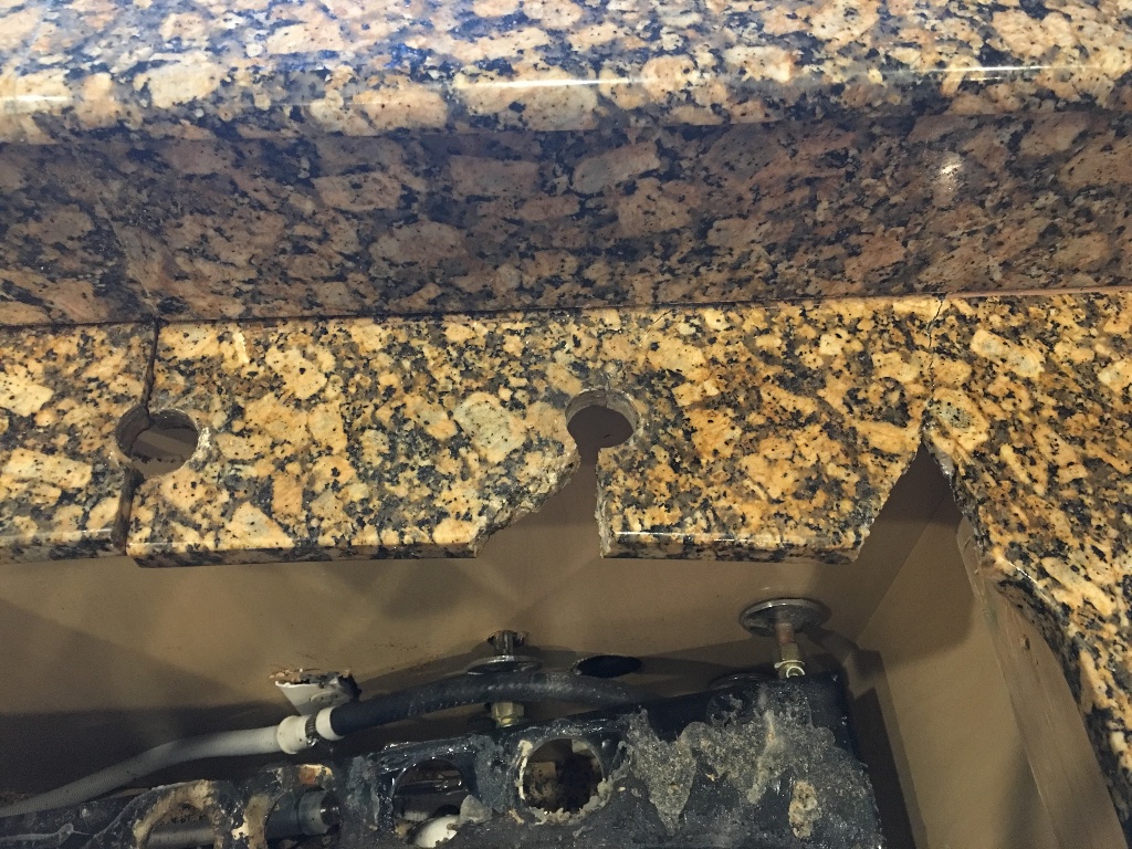

No top shimming, please. Cut the cabinet sides with a Rotozip so the sink slides in after you've popped off the cabinet front. The missing 2" or so of top cabinet is irrelevant if you strap your sink in place instead of using clips, because you're "replacing" the cabinet sides with 9" of vertical stainless steel sink sides.
I finally ran into a modern cabinet front that wouldn't tap off without splitting the other day. I just backed the screws out of the center cabinet style and rail, Rotozipped the top of the cabinet side styles enough to accommodate the sink flange and mount, slid the sink in, and the apron on the sink covered the cabinet damage. I reinstalled the center style and rail after the sink was in place:
By the way, that sink does not exist from Kohler. It's a 3943, but I've had the faucet deck welded on by a local metal fabricator. It's the only solution if they've got a "swoop" on one side that's deeper than 18 1/2" from the cabinet front. I'd tell you how much I got for this job, but you wouldn't believe it and Dan would delete it anyway. Even at $500.00 for the sink and $500.00 for the metal man, I'm still much less than top replacements. And the sink is spectacular, not the garbage many give away for free.
I'll have done one of these a month for the last 4 months when I pick up my next one this week. I've got a 5th for a rod repair, but the customer is still in price denial. I probably won't get that one until his handyman's "repair" blows up within the year or so.
Yes, I have cracked stone during a sink replacement, but that was because I was too stupid to check for and remove the blocking that held the cast iron sink in place before I beat the sink to death. It patched up nicely though:
